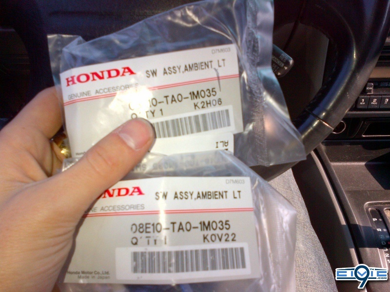

This DIY Deals with these special 5 pin powered switches from Honda
PN: 08E10-TA0-1M035
BUY IT HERE:http://www.collegehillshondaparts.c..._in=all&search_str=08E10-TA0-1M035&make=honda

STARTING FROM BOTTOM PIN IF SWITCH light icon points down
LIKE SO:
Pin 1- GROUND for illumination
Pin 2- Power/Live wire for illumination
Pin 3- GROUND for Switch
Pin 4- Power for switch
Pin 5- Positive, this completes the circuit for the on/off function
Hope this really helps some people! So no matter what you're doing you can have an OEM look on all your switching :D

There are screws that mount the ambient light switch? I thought those were pinch fit?
Whoa, been a while since i looked at this! The OEM button does not have screws, the JDM hazard switch does. I actually made a mistake while testing, all the wiring and trying different bulbs in the two buttons, and put the butterfly screw attachment which belongs with hazard light onto the OEM 5 pin button. I switched it back before installation.
