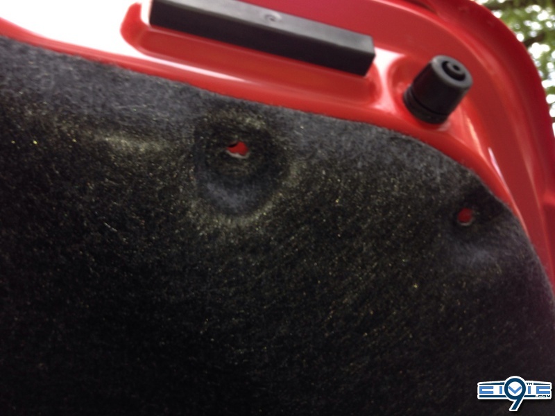

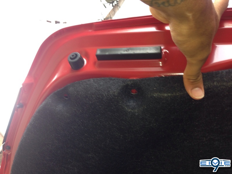

    First you have to un clip these clips 2 on each side
    [​IMG]
    [​IMG]

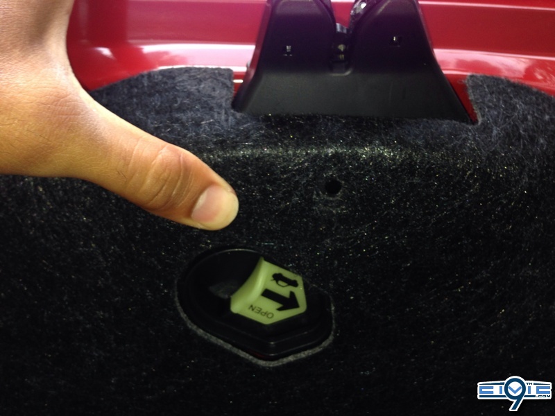

    then the Phillis screw in the middle
    [​IMG]

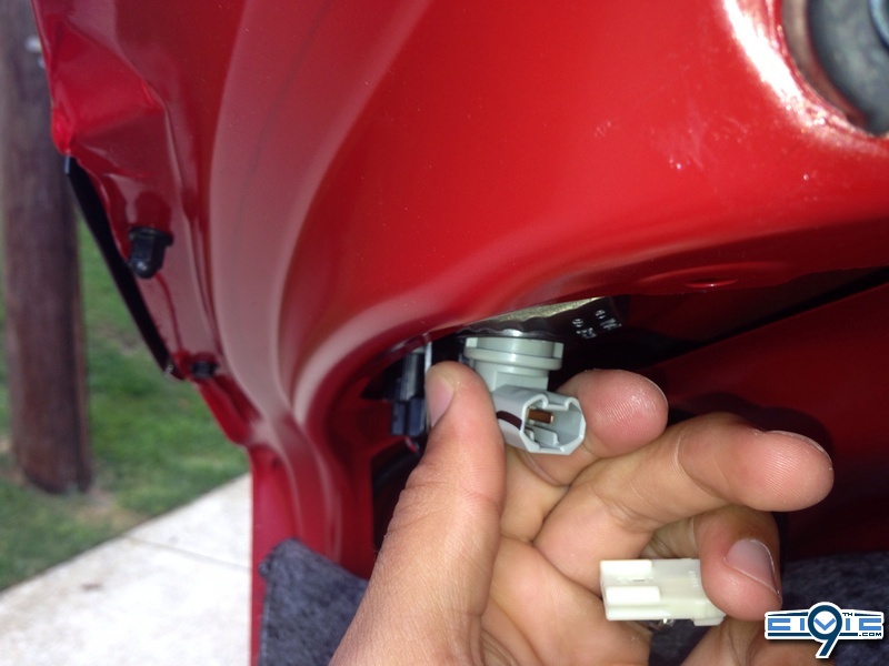

    then you want to move that carpet out your way and unclip these wire clips on both side
    [​IMG]
    TADA!!
    [​IMG]

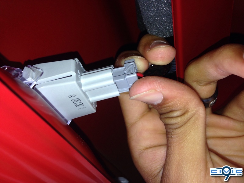

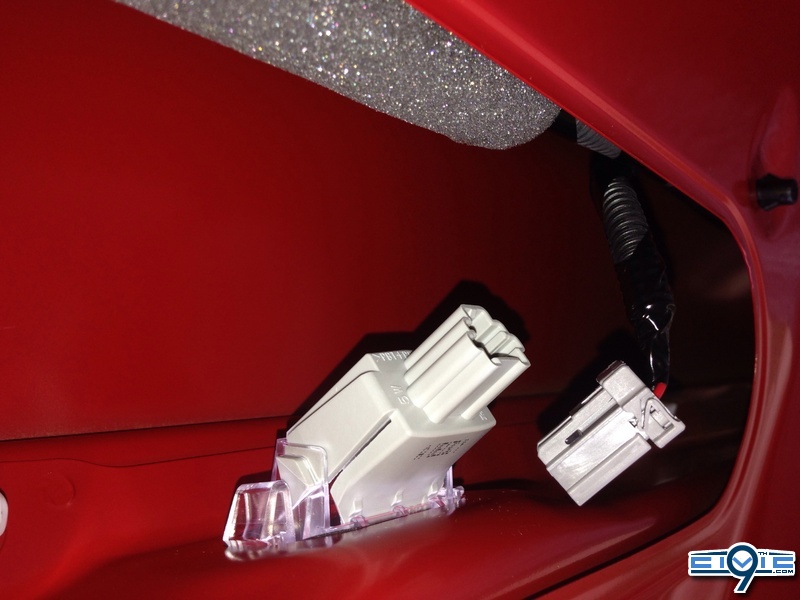

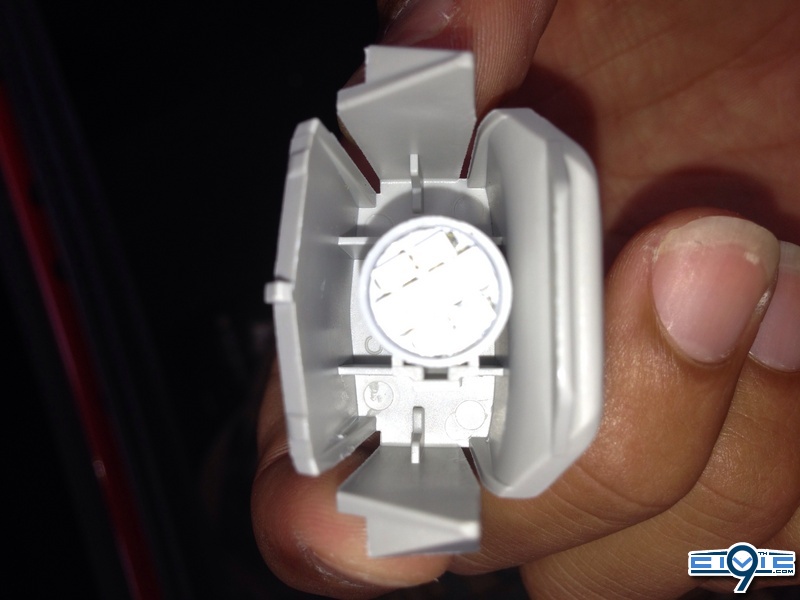

    then you have the bulb housing you want to pinch both sides like so
    [​IMG]

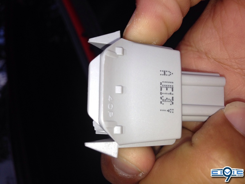

    take out the old bulb and replace with led bulb
    [​IMG]
    then just clip everything back on the same way

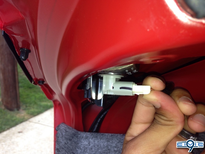

    While you have that carpet down might as well do you reverse light which are just as easy
    Unclip the wire
    [​IMG]
    and turn the bulb housing clockwise towards yourself and pull down like so
    [​IMG]
    then take off your old bulb insert the lED, insert the housing back in the hole and turn counter clock wise and insert cable again then just do the other side the same way
