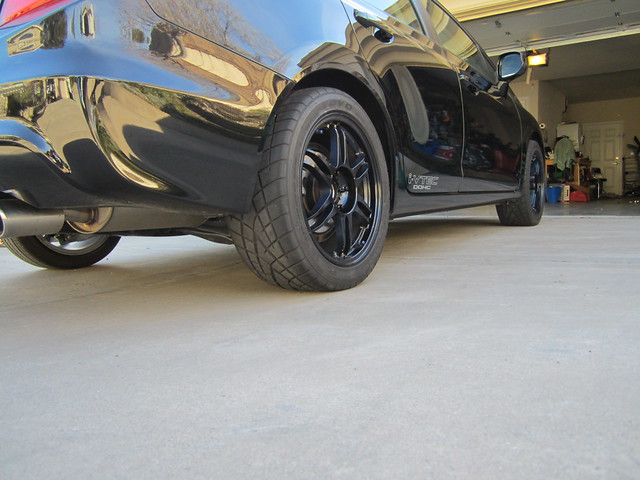

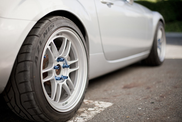

What suspension are you on? I had a set of 17x8 +45 Kosei's with 235/45/17's mounted and they cleared the struts up front by a couple of mm's. I've also run 235/40's on 17x9 RPF1s, on a different car, and yes they stretch a little bit, maybe more than my initial setup because RT615k's tend to be bigger than their actual measurements. Don't run the 215 on an 8. I've done that in the past and I immediately regretted it. If our suspension and body lines are anything like the 8th gens or DC5s, we **SHOULD** be able to run 245's safely. I haven't tried yet, so don't get mad if you try and it doesn't work out :hatsoff:

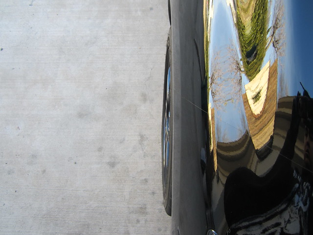

Here are some pictures for reference --
17x8 + 45 with the 235/45 on my car. remember, this is stock suspension, but it looks like everything would have cleared even with coilovers/springs.
Here's the 235/40/17 on a 17x9 RPF1. It's on my old Miata, but you get the idea --
Sweet, looks pretty good. For now im on stock suspension but just planning on hfp or koni setup in the future so I won't be going to low. My biggest concern was the wheels hitting the suspension. If I run into trouble I guess I could just throw spacers on. Aside from fitment how do the larger wheel/tires do for handling? Feel more grip?
