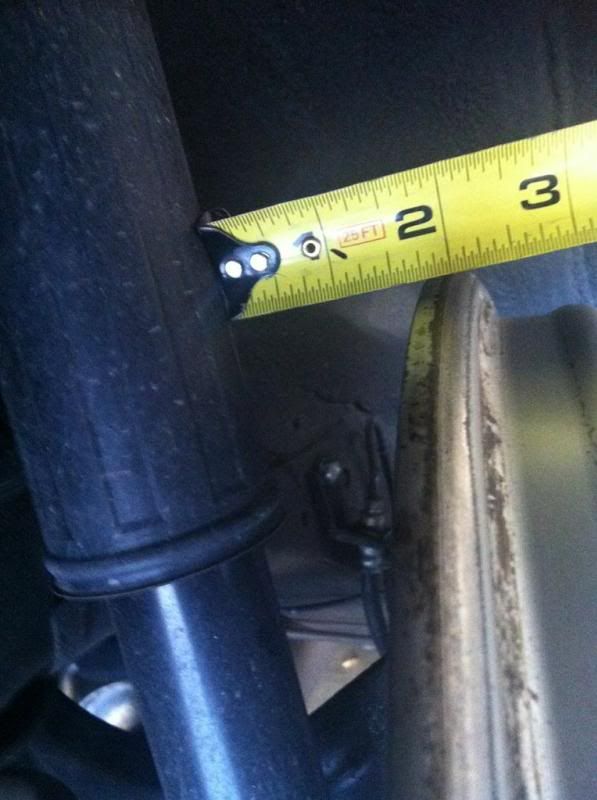

and for your other question here's inner clearance for a x8 +35. the rears have plenty of room, but i forgot to take a picture of the fronts. there are people on here running x9 +35et with 235/40s, so i'm pretty sure you can run that 17x8.5 +35 setup with no issues
rears -

The rears certainly fit, I know a few people who ran wide tires had to run a minimal spacer to clear the fronts. Like 3mm which will work with stock studs.
