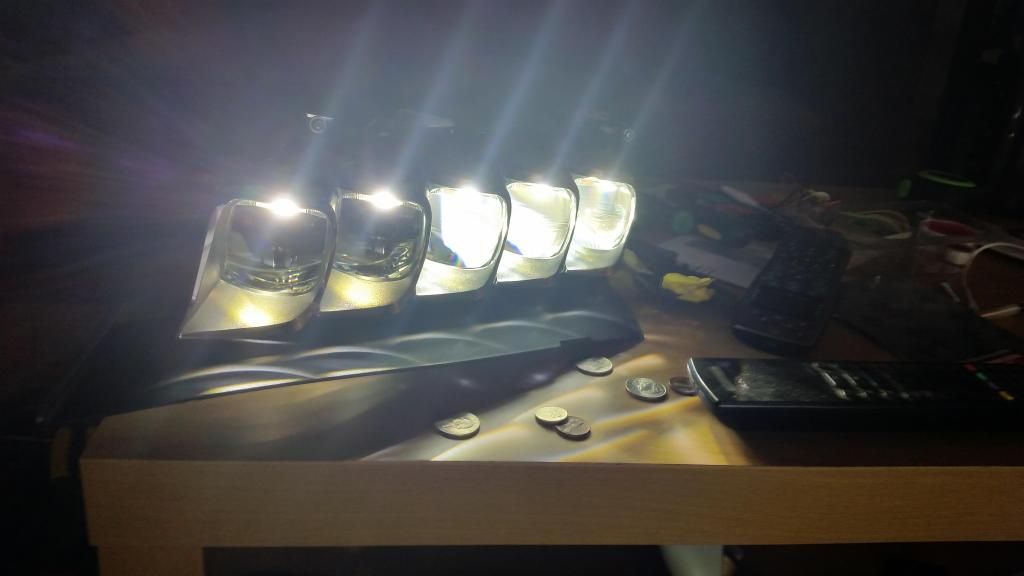

the leds are high power emitters, so they do tend to heat up, if they werent heat sinked, as the emitters heated up they would draw more power creating more heat and eventually go into thermal runaway until they blew up
theres 2 emitters for each lens in the jewel array, the high power emitters for low and high beams, which shoot into those chrome parabolic scoops, and then a strip of lower power leds across the top that make the lenses light up for the DRL
now i want to see if the control puck will let me send power to the DRL signal and the low beams, so that i can have the power of the low beams but have all 5 lenses lit up
you can see the light at the top of each lens is the drl emitter, and then the 3 brighter lenses are running the low beams
so when you run the lows, you'll still have a little light out of the 2 highs? That's what you're after/testing?
ill be able to, not sure if its a good idea, i dont think the MDX does it stock, probably due to heat concerns
