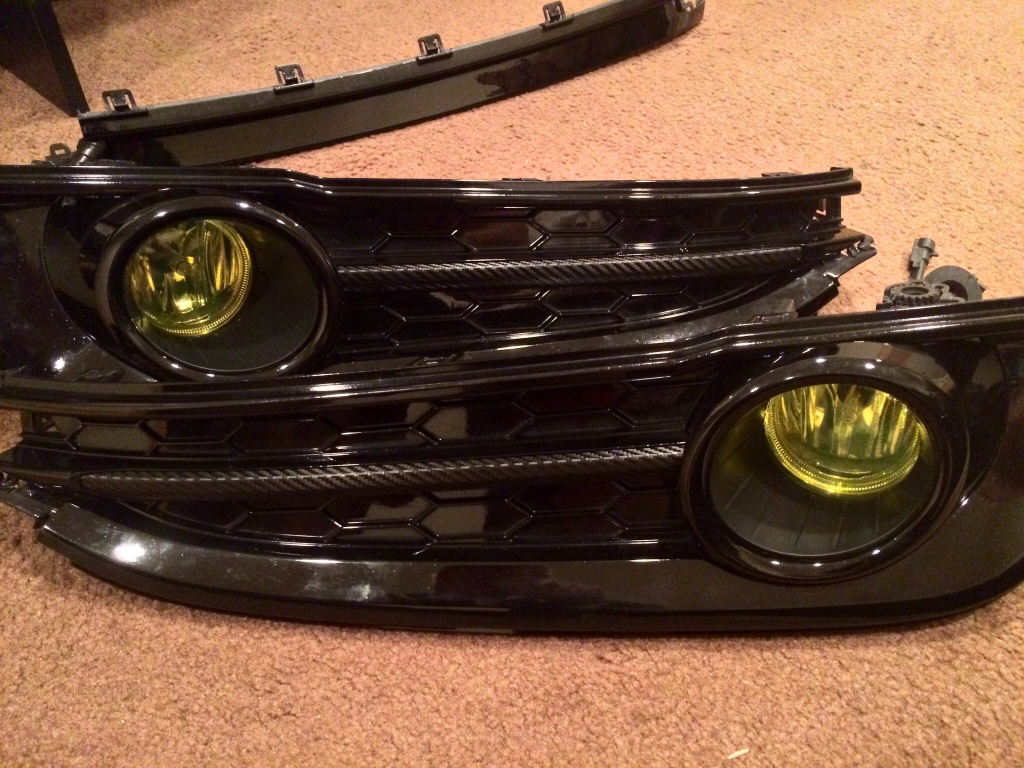

To get the smaller bumper chrome pieces the bumper will have to come off. On the inside of the bumper you will see that the whole unit that stretches the length of the bumper that includes the fogs has many clips. You will have to slowly loosen all of the clips and you will end up having something that looks like this
It will be three pieces.
The piece in the rear of the picture is the plastic the sits between each fog light.
Now when all these pieces come out they will come out as one piece. They are clipped together as well!

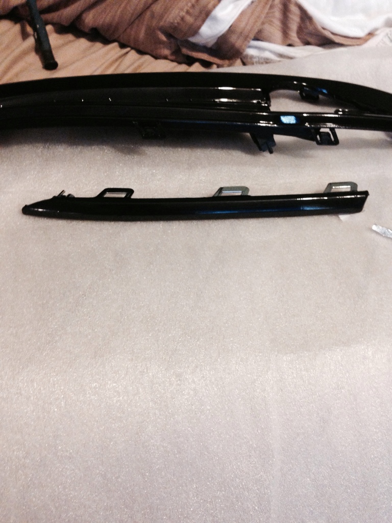

On the back side of the smaller chrome pieces I believe there is on screw on each and then it's just clipped in.
Be careful with all of these clips. I used a small flat head to pry them all out. Luckily I didn't break any!. Good luck! If you have any other questions feel free to ask!
Correct 1 Philips screw and 6 clips.
