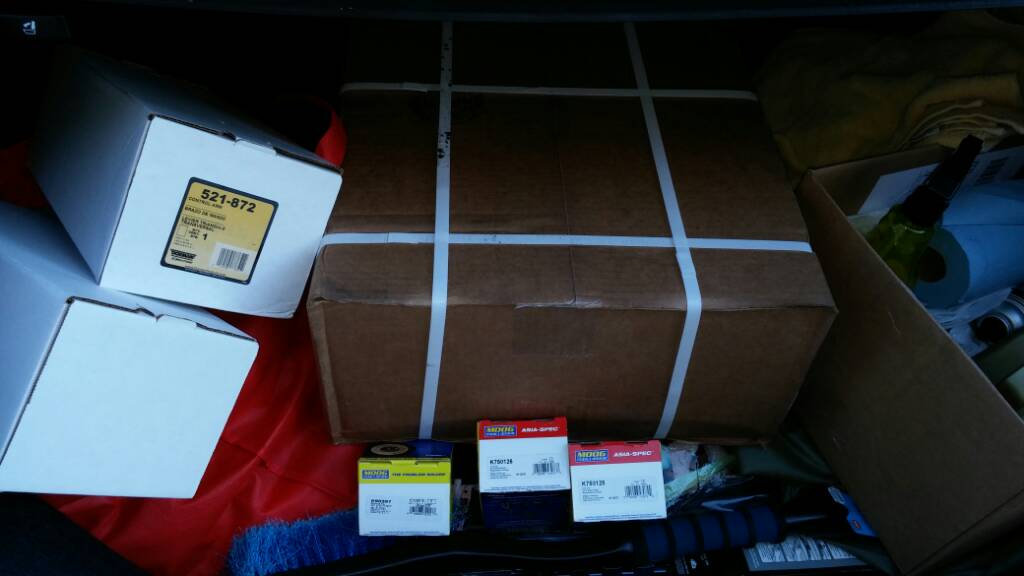

Hello all!
Here's a quick pic of some of the suspension goodies slated for install this coming Monday :
As for what's inside the box? H&R Sport Springs. I've also got my 22mm Progress rsb arriving tomorrow.
So looking forward to getting these goodies on!
