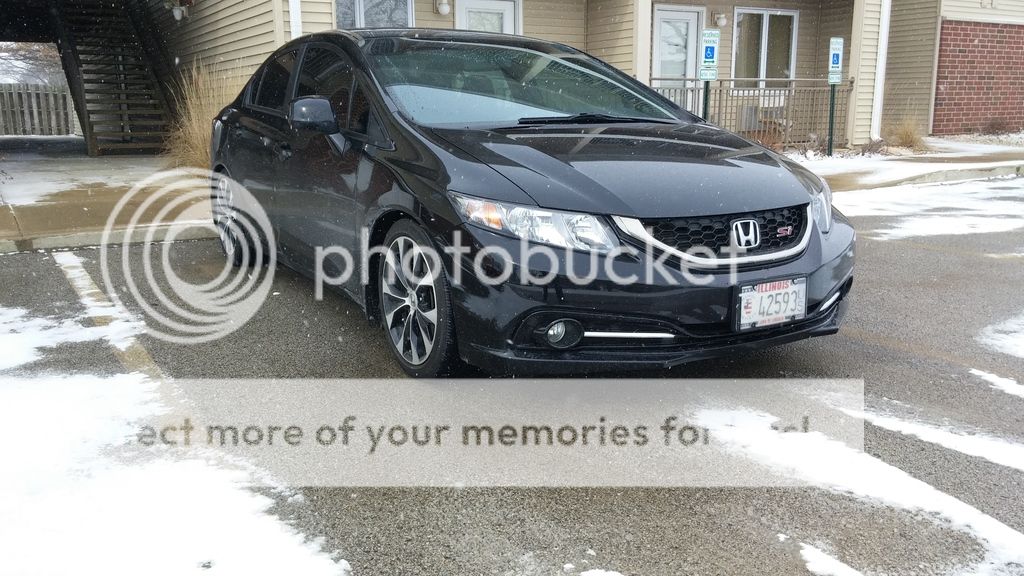

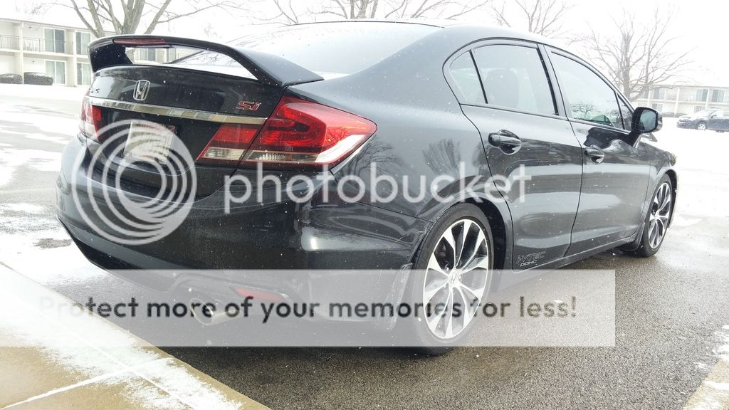

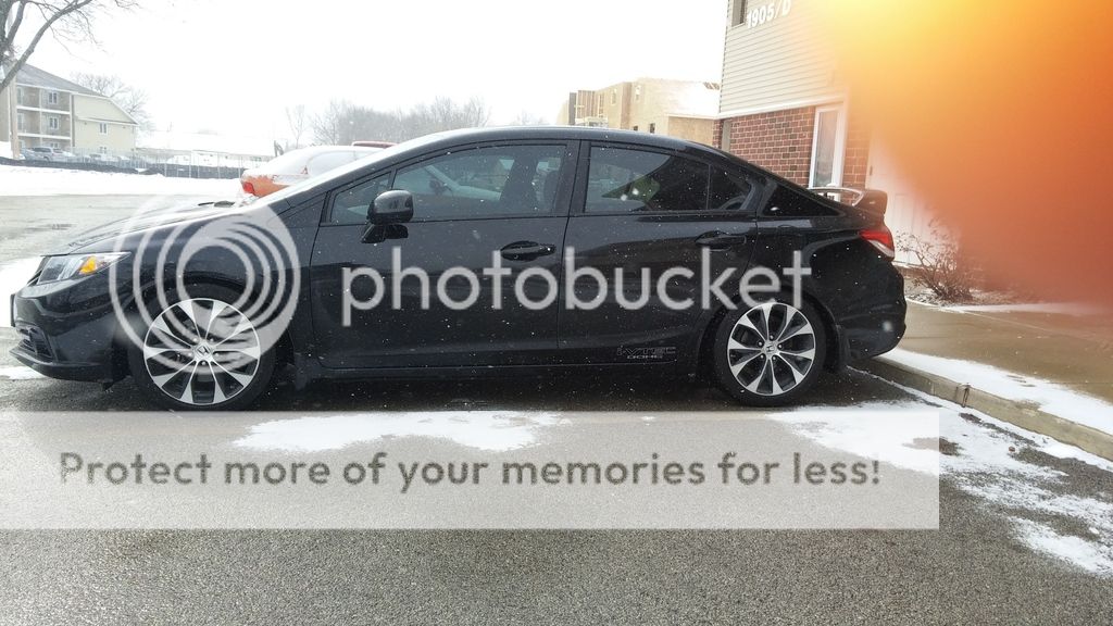

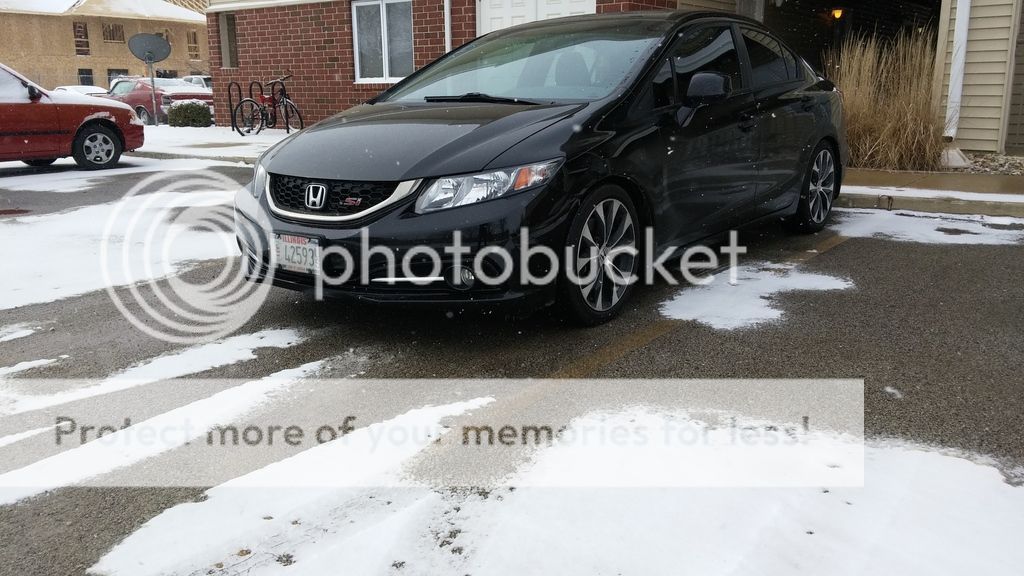

Finally! Lowered with H&R Sports, Dorman/SPC camber arms (rear), SPC camber bolts, and one costly stock alignment later and here she is:
Still need to install my 22mm. Progress with Moog endlinks/bushings though, which will hopefully be done next week.
The handling is a tad better than the stock 4x4 height... but the way the weather is right now, along with these crappy handling stock Michelin HX MXM4 tires, I'm going to take things easy until things clear up.
Will the 22mm. Progress actually make that big of a difference in the rear end handling? I hope so.
and the new ride height you have looks very good
Thanks! Can't wait for the weather to be more cooperative so I can clean/detail her properly. Plus, when it does warm up a bit, I need to get my tint redone (which is under warranty). It was supposed to be 35 F/20 B, but the tech only did 20% on the rear window and rest was done in 35%. smh. But the shop that did the work is rather cool, and will correct everything under warranty for free. :)
