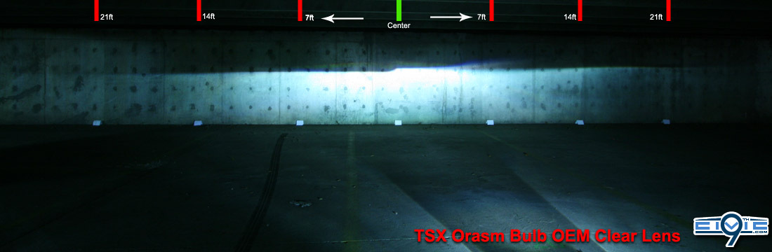

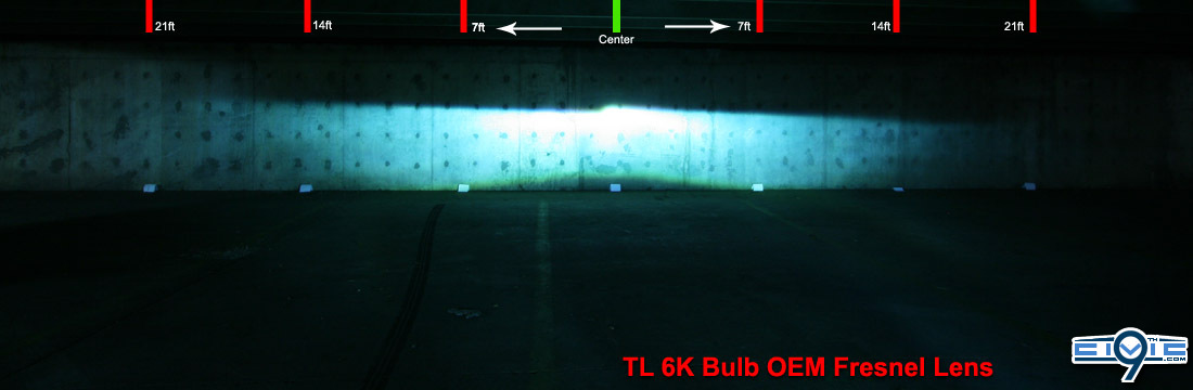

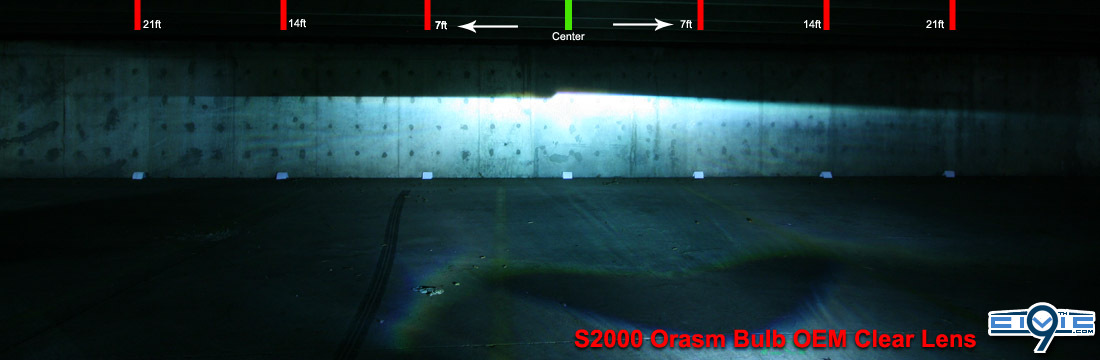

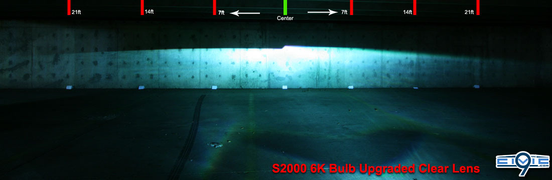

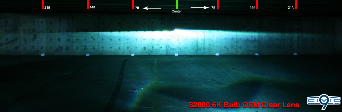

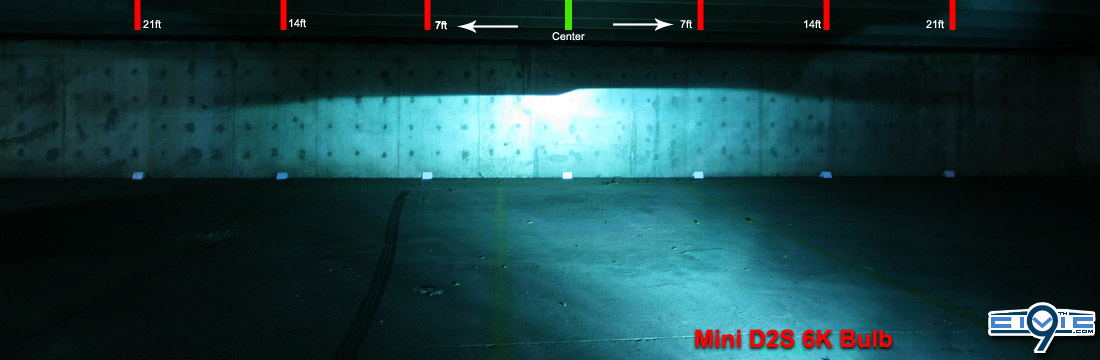

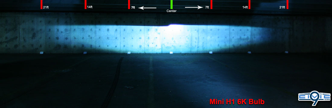

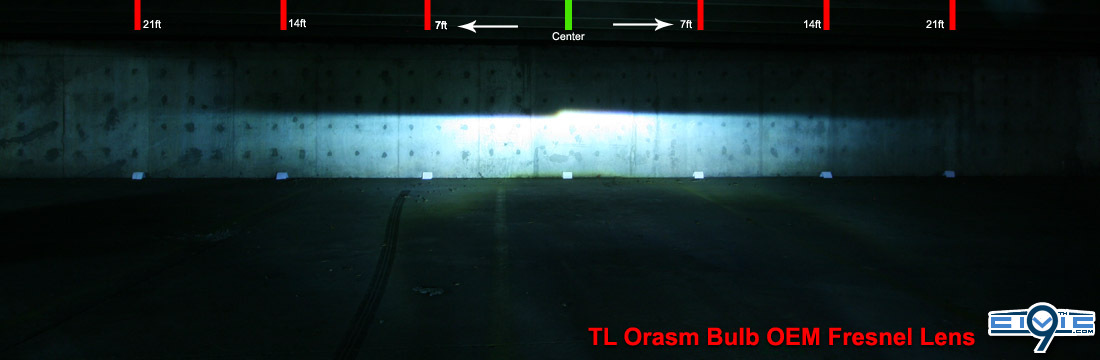

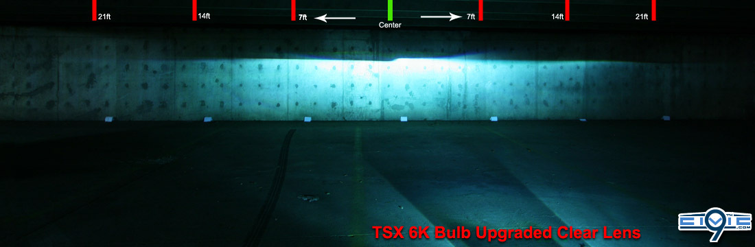

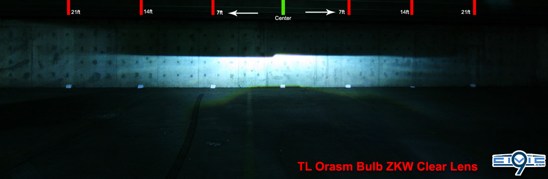

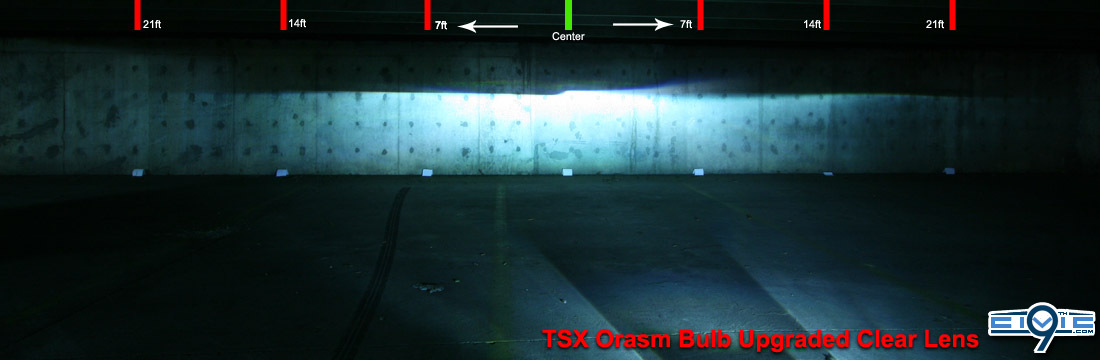

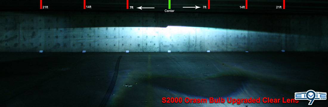

Little explanation of how each photo was taken:
I tried to place the cutoff shield step near the center line for each picture. There are white pieces of paper at the base of the wall indicating 7ft increments. I've also created lines in photoshop to purely mark them. These are just points so you can gauge each picture and compare their properties. All of the shots were taken on a tripod at 25ft from the wall.
Each photo was taken in manual camera mode with the same setting. If one picture looks brighter or darker, that is a characteristic of the projector. With each photo being taken with the same properties, the camera will not adjust to make them all look the same as far as brightness etc. There are zero adjustments to color, contrast, brightness, sharpness etc in photoshop.
Bulbs Used:
H1 Bulb - generic 6000k ebay bulb
Generic D2S 6000k ebay bulb
Orasm D2S Bulb
On To The Pics:
Mini D2S Orasm Bulb
Mini D2S 6K Bulb
Mini H1 6K Bulb
TSX Orasm Bulb Stock Clear Lens

TSX Orasm Bulb Upgraded Clear Lens
TSX 6K Bulb Upgraded Clear Lens
S2000 6K Bulb OEM Clear Lens
S2000 Orasm Bulb OEM Clear Lens
S2000 6K Bulb Upgraded Clear Lens
S2000 Orasm Bulb Upgraded Clear Lens
TL Orasm Bulb OEM Fresnel Lens
TL 6K Bulb OEM Fresnel Lens
TL Orasm Bulb Upgraded ZKW Clear Lens

Hope you enjoyed
Round 1 Of Testing - if you missed it @ the link below
http://9thcivic.com/forum/threads/hid-projector-comparisons.7494/
