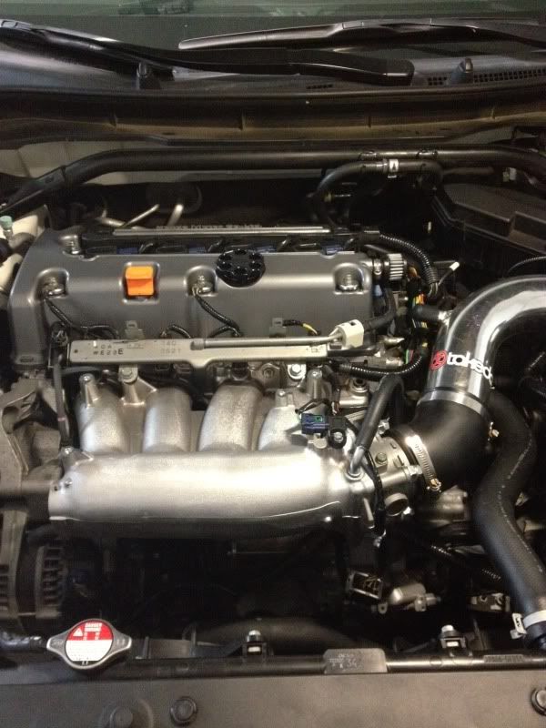

I heard this:
You need a pipe plug for the water hole in the top of the manifold.
The DBW wiring needs to be shifted to reach the TB, we took the plastic wire loom off to have more slack in the wires.
A few hoses need to be lengthened and a T fitting for the brake booster and the other line next to it need to be T together.
Water jacked can be used the way it is but using a dremel to get it more open to the TSX flange is better. We used 09 TSX P2r gasket on the head and also a 06 si gasket 64mm on the TB.
The TB bolts need to be about a 1/2" shorter and that is about it.
Here's what it looks like installed on the current tsx:

That's what I'm waiting for, I have an rbc manifold and aem fuel rail test mounted on a z7 on the floor of our shop right now. I'm just waiting for flashpro to come out so I can tune it after.
4130 Fabrication has installed a RBC IM with 2006+ fuel system on a 2012 Si.
Yeah! This is their (4130 Fabrication) description:
And they said it couldn't be done. Rbc intake on Harry sparks 2012 civic Si little welding and there you have it. Harry installed this last night and it is working just fine. Got to get back to the dyno to see the hp gain. Good job Harry.
It seems like it took a lot of work.
