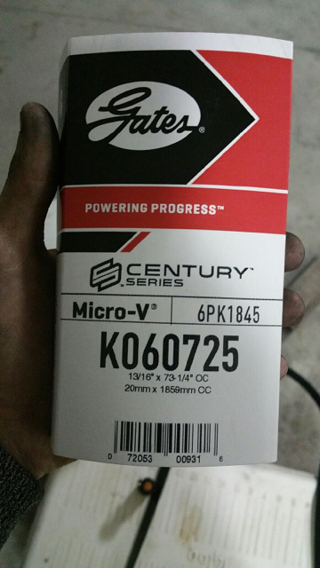

This is the belt size for the 110mm pulley.
I ran this belt size with my 110mm puulley, because it came with the kit. It was loose, causing belt slip and only 8psi of boost. That was with tension adjustment screw at max tightness.
I replaced it with the K060721 and it has worked great. Consistant 12+ psi
My average is 12.5. Hits slightly lower when its hot out, like 11.7-11.9. Has hit as high as 13.1 once on a crisp cold night.
Gates belts with part numbers according to pulley size I gathered from contacting kraftwerks a while back.
Im currently running the k060725 on my 120mm pulley
120mm K060725
110mm K060721
105mm K060716
