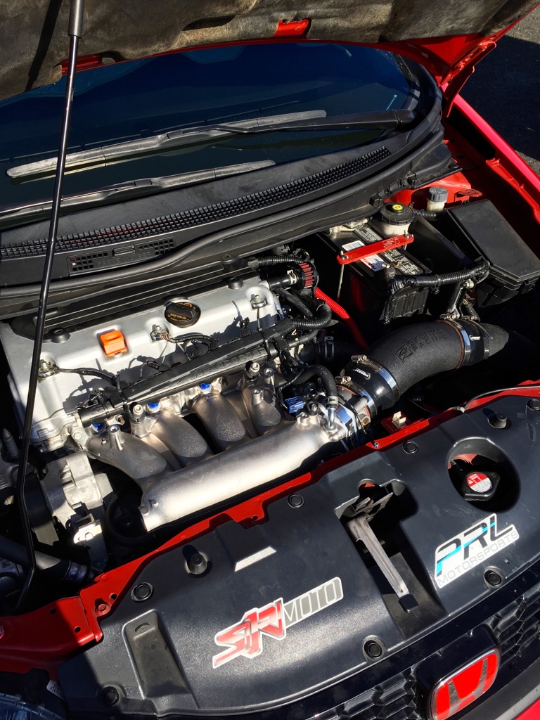

So procivic did not have the grams throttle so instead they are going to send the OEM Big bored throttle (J37 motor basically a MDX throttle) so I am waiting on that to install the RBC and the throttle!!! Next up are the Denso RDX injectors
And will be adding to this the skunk2 composite fuel rail!!!
So installed the J37 throttle body, Denso 410CC injectors, RBC manifold and skunk2 fuel rail!!!
So this is the "issues" I have Yesterday the car would not go pass 3,000 rpm, today it goes pass 3,000, but today like some guys here I have a idle problem that goes from 1,000 rpm and 1,200 rpm on neutral and when driving if I go from 3rd gear to neutral the rpm go down and up down and up until they reach 1,000 rpm
I'm thinking is a learning curve due that yesterday it wouldn't go pass 3,000 and today it does.
I haven't tuned it yet. What you guys think?
