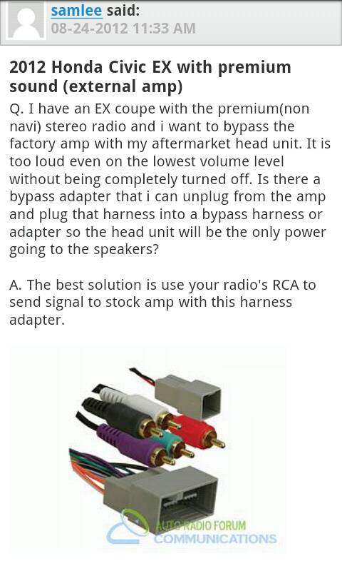

Just curious as to why the harness adapters has rca's on it. Most aftermarket radios already have rca pre outs for sub rear and front channels. What are the ones on the harness used for?
Lol I was actually thinking the same thing. When I go to install tomorrow I will figure out what they are used/not used for. I hope my local store gave me the right adapter.

You shouldn't ever have to use a LOC with an aftermarket deck. The harness adapter should either feed the stock amp like the stock deck does or come with a connector to bypass it. If running aftermarket amps those can be fed straight from the preamps off of the aftermarket deck.
That's what I thought but on the harness there where aux plus or the speakers, so in order to hook up to the speakers I needed to use it. It came out perfect though sounds nice and crisp. I bought a relay so I can bypass the e brake I'm posting a pic of what numbers to plug the wires into now.
Sounds like there should be a connector to jump the speaker inputs of the stock amp to the speaker wires on the output side so that the speaker wires from your head feeds the speakers and bypassed the amp. You've done a very nice job don't take me the wrong way but if you need an LOC to wire up an aftermarket head then somethings wrong. In the very least I would have spliced the speaker outs from the aftermarket head to the speaker outputs of the stock amp but even that should be covered by a harness adapter.
Looks like the RCA's on the harness adapter you got connect to the pre outs on your aftermarket deck and those will feed the stock amp through your harness.
Yea but there where no aux wires or plugs like that. I think that's why I needed it? Idk I've have seen that before so I guess I took a dif route. But thanks for the info. Did you see the way to relay the e brake so ( a passenger can watch movies while In motion) lol
The harness in your pic in then first post has the rca plugs in was asking about. I believe those plug into the rca outputs on your aftermarket deck and that's how the signal is fed to the stock amp from the aftermarket head. On the ebrake thing I have no clue. That's not something I've messed with yet.
