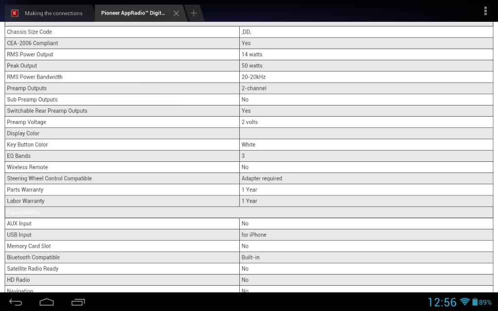

I prob wasted some money but I'm just happy it's in and works like a champ. I installed all new software n firmware but the Bluetooth sounds like the phone was dropped in water lol. I'm calling pioneer tomorrow
OK I think I see what you did. If this is the case then your correct.
Judging by this your deck only has one pre out and its for the rear channel. So they just used the LOC to feed the RCA's in your harness from the speaker wires. That's a good way to do it since if you fed everything off of the pre outs you would only have 2 channels of signal going to everything. This is good info though so thanks for that. This let's me know that the harness does in fact feed the amp and not bypass it but also for my application I need to get a deck that has front, rear, and sub pre outs.

Here is a simpler pic of what I did with the line out converter. The purple, grey, and white are the aux wires from the harness that I was talking about.
Yeah I see what you did and you're right, you had to because that deck only has 1 set of pre outs. I assumed it had pre outs for rear front and subs but I was wrong. I just figured it would because that became the norm 10 years ago when I used to compete in car audio. There were actually a few decks back then that had no internal amp and only pre outs because everyone was using aftermarket amps.
Yea so now when I install a system I have that one set I can use for my subs. I want the Memphis m5
This is true. I'm glad to know that so I know to pay attention to the pre outs before I buy a deck. I really really like that appradio so it kinda bums me out there's only 1 set.
Yea but I'm not even sure if I want a system. And this is the app radio 1 not the 2 so I would look into it
I might look into the 2. The reason I mentioned the pre outs isn't for adding a system, which I already have, its just that I would feel better going straight from the pre outs to the stock amp instead of having to use a LOC. One of the side goals I have for getting an aftermarket deck in the first place is to get rid of my LOC.
