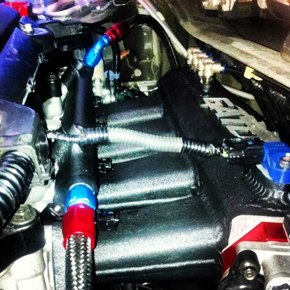

You "can" get more power with a larger exhaust but the real restriction is that cat first thing on the exhaust side. The test pipe is really really loud though. Even the R18 supercharger kits are being run and tested with the stock exhaust. The real weak point in FI setups on the R18 is the intake manifold. It's a type of plastic and it tends to fold under higher boost pressures. There is an aftermarket one from Weapon R that apparently works very well but is $600 on its own.
