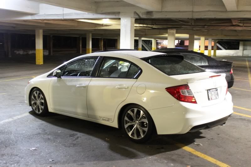

Um so I thought I should start this considering people are so curious on how sedans look dropped and soon enough many 9ths will be dropped I will start off with my 9th

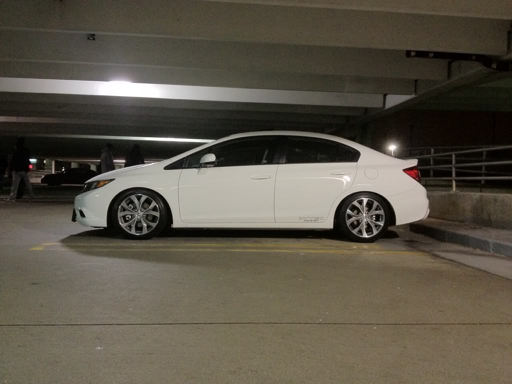

I'm lowered on Skunk 2 springs from 8th civic

Which Skunk2's are these? How many inches?
Part No: 519-05-1580
Front Spring Rate (Tender / Main): 135 lb-in / 184 lb-in
Rear Spring Rate (Tender / Main): 125 lb-in / 273 lb-in
Drop (Front / Rear): 2.25” / 2.00”
Note: 1 lb-in = 0.0179 kg/mm
I would not use ^ though. Those are made for the 8th gen. You need to buy rear spring isolators to run those, and you'll spend more than just buying the 9th gens springs they make.
