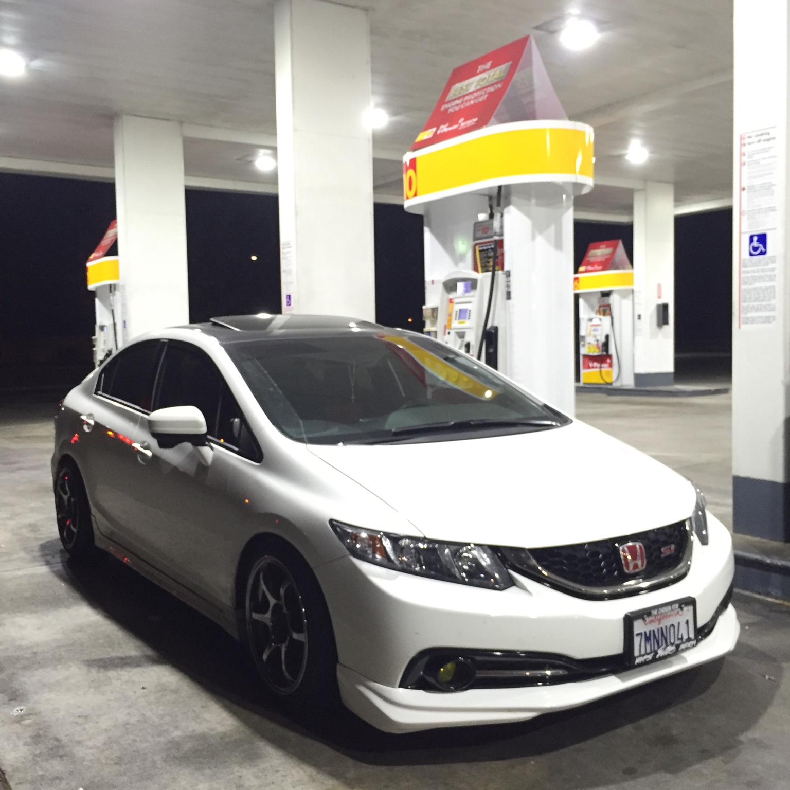

here are 20mm spacers all around. Lowered on h&r springs. He also adjusted camber front and rear though. You could send him a private message, because he hasn't been online in years.
http://9thcivic.com/forum/conversations/add?to=liljusepy That will send him an email alert to see if he rubbed at all. I think it'd be very close on bumps if you don't adjust camber from looking at his pictures.

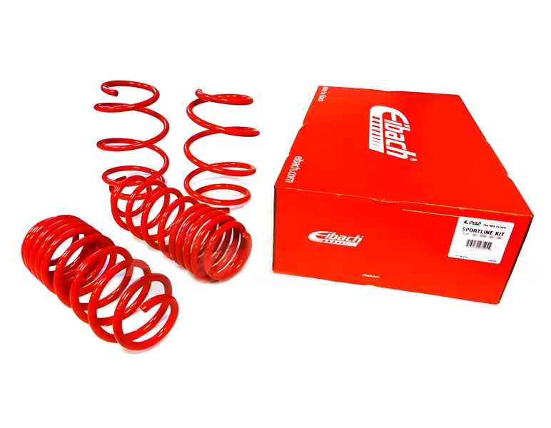

anyone have a link for the Eibach Sportlines springs ? Really liking the drop they have to offer, is it important to also change the shocks / struts I'm at 148k km's currently
2013 si sedan eibach sportlines above
shocks & struts - your oem shocks & struts are likely worn out on your car. These options above are for aftermarket lowering springs. The koni shocks are not direct bolt on, so I would advise you to pick something else unless you want to deal with modifying the stock struts.
You can also go for a coilover setup if you'd like. They will have the shocks, struts and springs in one package.
