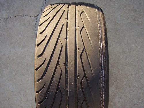

Toe eats tires much worse than camber but if you are only puttering around town running over -2 degrees of camber will visibly wear your tires and shorten their life. The guy claiming to run -4 degrees of camber in that article only says that he runs -4 on the front and makes no mention of his rear camber setting. It could be 0. If so, rotating tires regularly will extend their life despite such an extreme number.
Factory alignment specs are there for a reason. They provide a decent balance of handling and tire wear that most of the general, non-enthusiast, non-performance driving public would accept.
Run -4 degrees of camber and tell me your tires don't look like this on the inside shoulders after a few thousand miles. This tire was run at -2.5, camber does wear tires especially if it is far out of factory spec.
