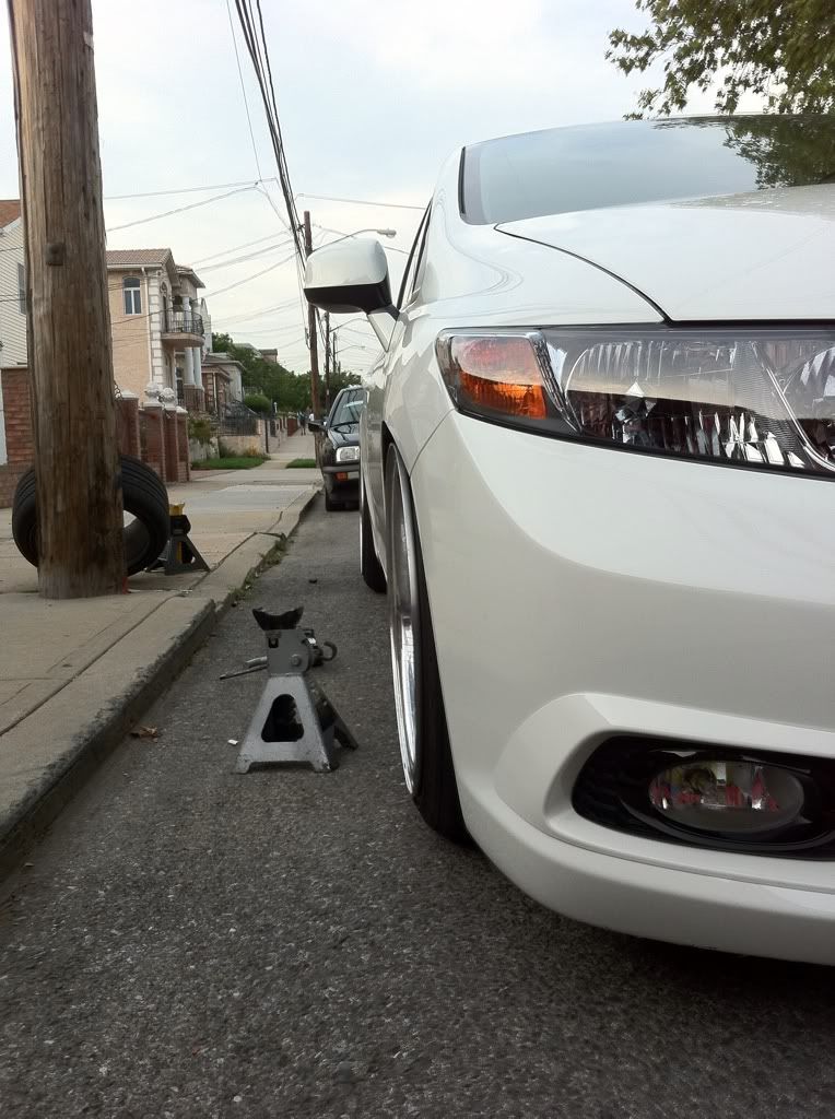

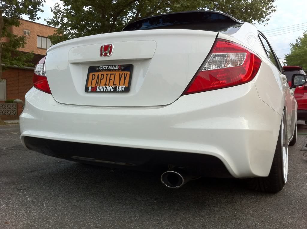

18x9.5 +43 :/ there my boys wheels though , offset I believe messed up the poke

That offset would be perfectly flush/very slightly poked with a more function oriented alignment, but with a lot of negative camber for style purposes, you're right it's not the right offset. Wheels still look super nice though.

yeah I loved it maybe with a 235 tire or 225 it would of been flushed

I guess I'm the only one here that doesn't like poke. I think the wheel setup is perfect. Maybe a 225 or 235 if it didn't rub
