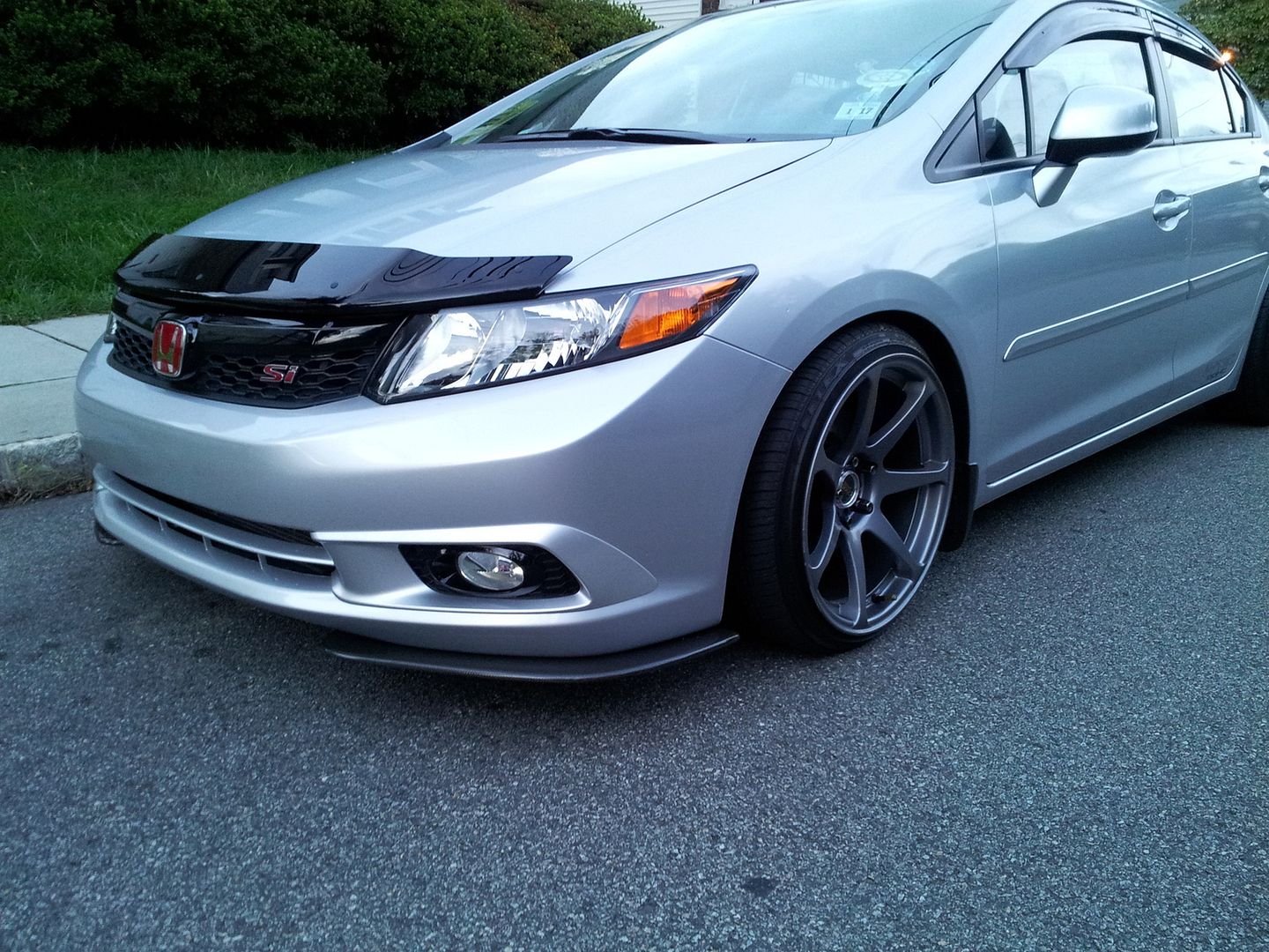

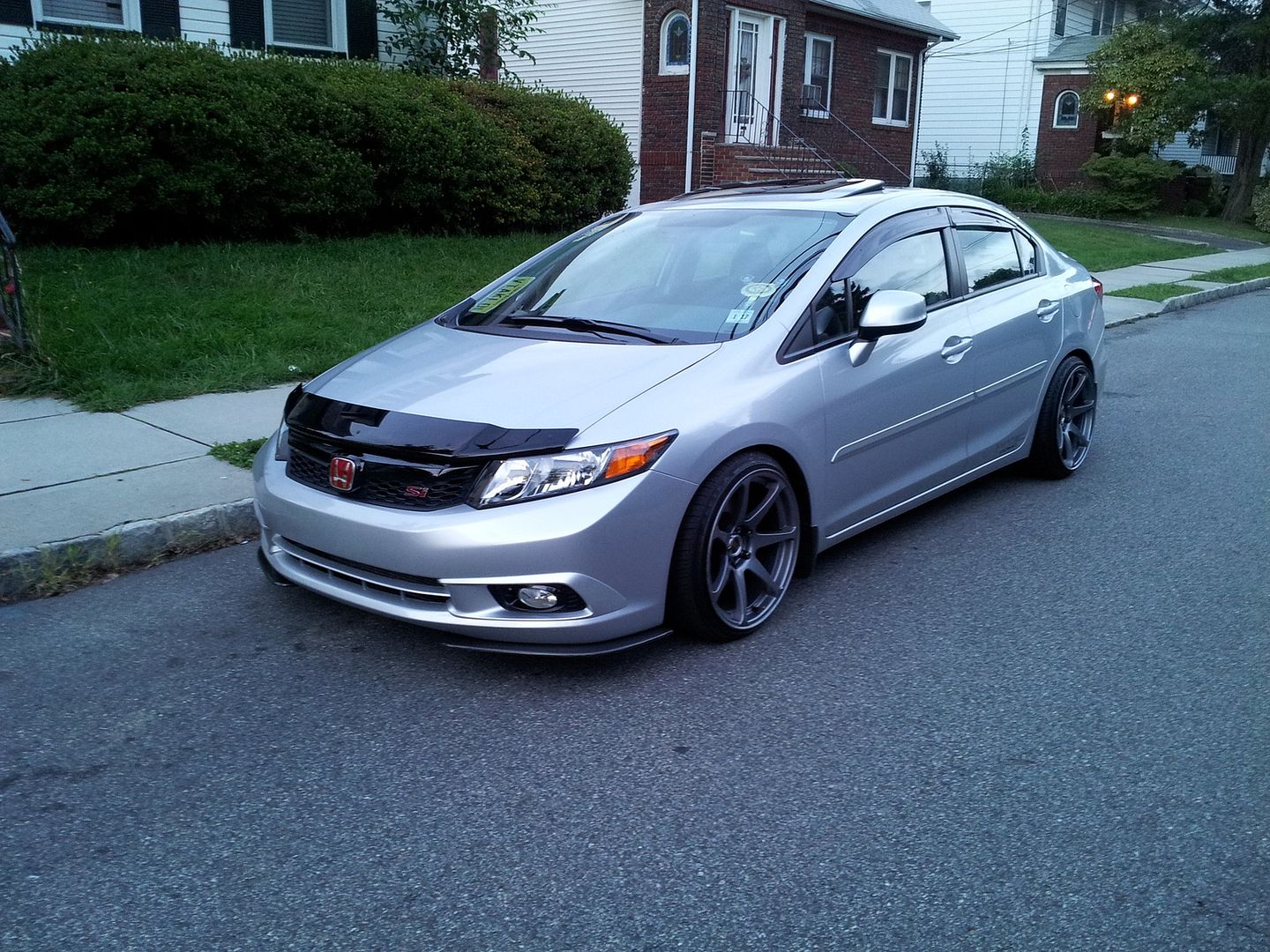

Um so I thought I should start this considering people are so curious on how sedans look dropped and soon enough many 9ths will be dropped I will start off with my 9th
I'm lowered on Skunk 2 springs from 8th civic

mines is on 8th gen si skunk 2 springswhat kind of lowering springs do you have it on?
do they fit good or do you need to change the isolators? and are you on stock struts?mines is on 8th gen si skunk 2 springs
needa change to the 8th gen isolators..its on stock strutsdo they fit good or do you need to change the isolators? and are you on stock struts?
do you think the stock struts will need to be replaced soon from wear and tear? sorry about all of these questions i am just trying to get the best deal and look for the car you know.needa change to the 8th gen isolators..its on stock struts
Question, what tire specs do you have? I want some of those wheels but I was thinking of doing 205/40/17 but I would like to know how the ride quality is. And did you use a.camber kit? Thanks
no camber kits since i was on sk2 springs
ride was not that bad. but not that great either because of the 35' series tires.
specs are 215/35/18 18x9.5 +23
..hard to believe something that looks that badass is only dropped on skunk2 springs
