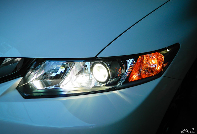

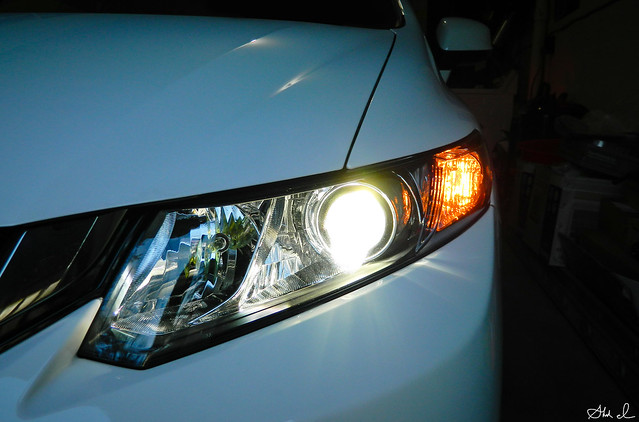

s2000 retrofit done by customlightz
ap1 s2000 projectors
mdx shrouds
color mod stage I & II
philips 85122+ bulbs

Modded Mini h1 6.0
Iris Shrouds
5k morimoto 3five bulbs

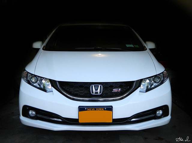

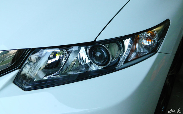

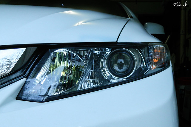

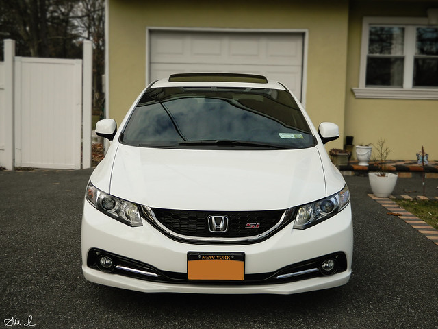

sideshotlightsoff by yoitsshad, on Flickr
sideshotlightson by yoitsshad, on Flickr
frontshotlightsoff by yoitsshad, on Flickr
frontshotlightson by yoitsshad, on Flickr
frontshotlightsoff2 by yoitsshad, on Flickr

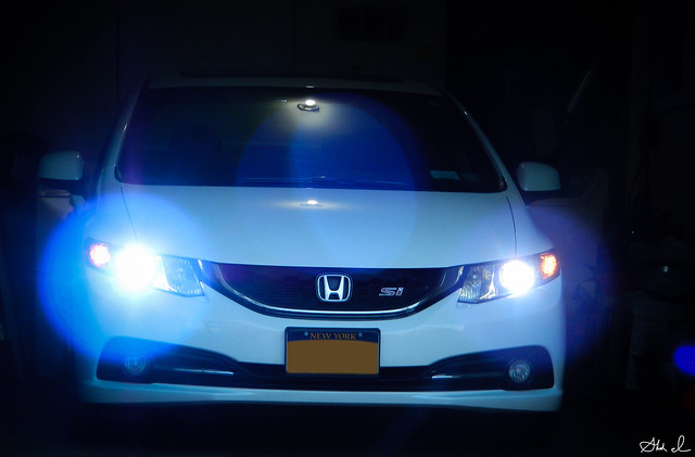

colorflickr by yoitsshad, on Flickr
That's a great setup. Seeing you are from Ny. Where did you get this setup done? I'm from Jersey and planning on having something similar. How is the cut off from the headlights. Also how much would something like this be around?
I did it myself, it took 2 days (took my time). This is also the third retrofit I have ever done (did 2 setups for 8th's) so I have experience. However, this is the first retrofit I have done which required me to trim the back of our headlight housing so that the mini h1 can properly be mounted as well as the bulb can be properly seated. It was also the first time I had to trim and test the shrouds to ensure a good fit (took hours). Cut-off is great for the mini's, never had a issue. Price varies depending on your options.
Awesome Photos!
Great looking retrofit.
The color flicker in the last photo is amazing. Nicely Done!

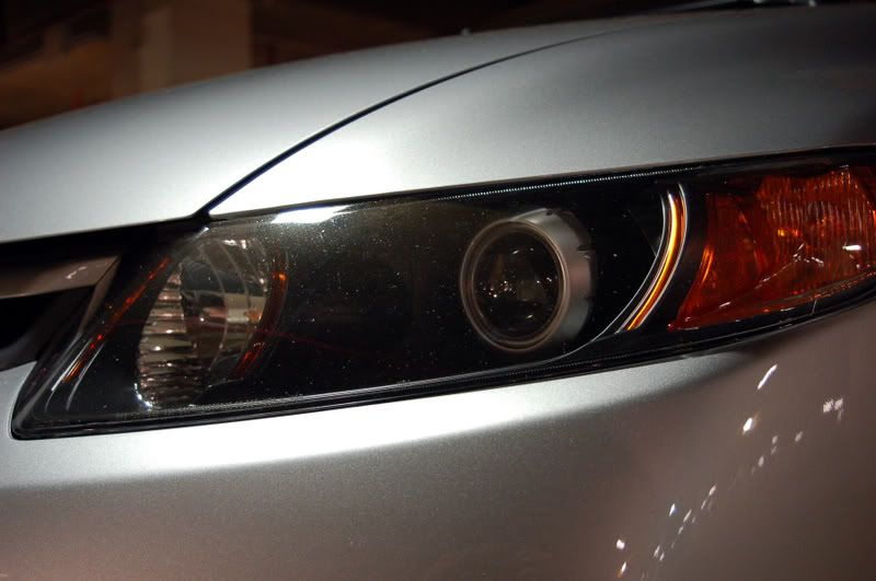

Anyone have any idea how this was done? What projector they used and where you can buy the curved TypeR-like LEimage.jpg D strip?
Anyone have any idea how this was done? What projector they used and where you can buy the curved TypeR-like LED strip?
The strip looks like the standard rope LED that you can find on eBay.
