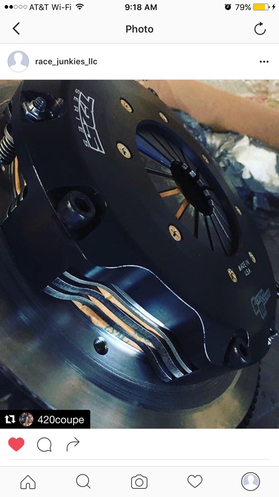

This should solve clutch slippage
World's fastest Honda Civic R18A1
