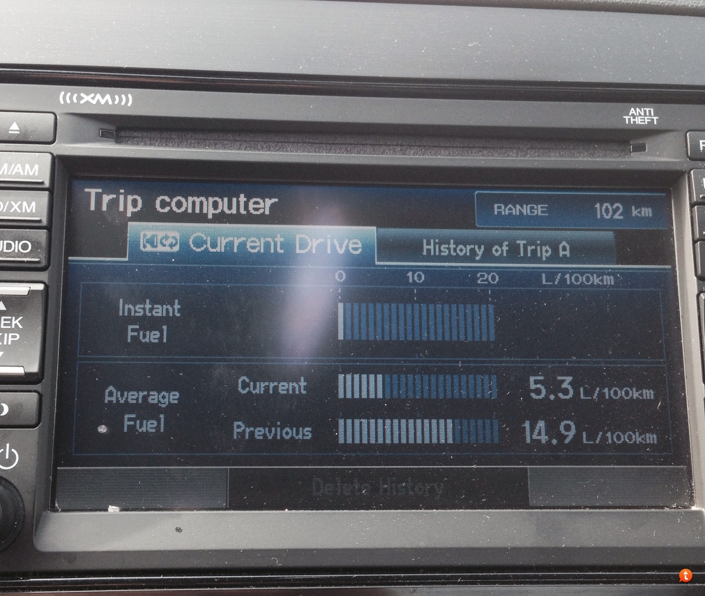

I just got an oil change and refilled my gas yesterday. My Ex is at 6900 miles now and my last tank got me 36.8 mpg with Econ off according to my trip computer. I drive about 70% highway/30% city. Been using 89 octane ever since I got the car. I have a feeling the warm weather has more to do with my increased MPG. My car was getting about 33-34 mpg in the winter months driving the same routes.
