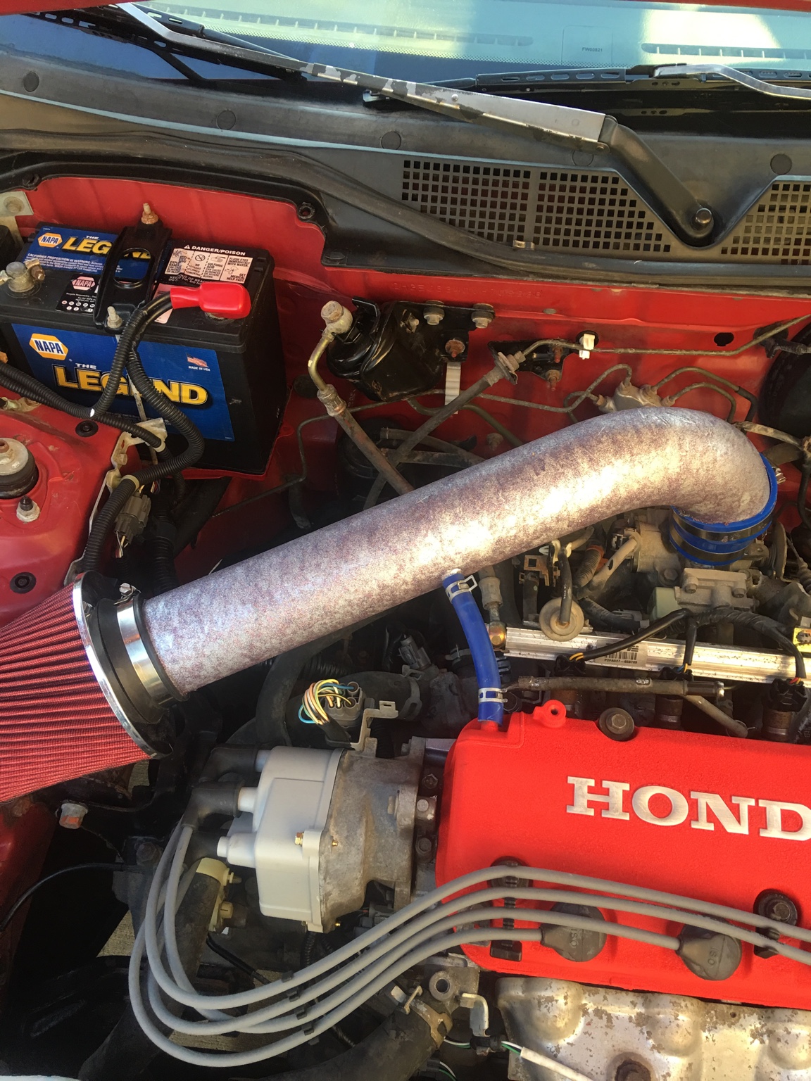

That eBay intake, glitter paint, and don't care!
What block is that? I have a 95 del sol for the same reason. I'm a electrician and there are some job sites I can't take my civic unless I want it to be dented and scratched.
Might pick up a few hp and some mileage if you swap the y7 manifold for a y8 manifold and throttle body. Better flow on the cheap.
I was thinking about that, but motors due for a tbelt change and I want a y8 tranny. So I might just grab a y8 harness, ecu, long block, and tranny to swap it.
Check your price options a mini me head swap could be cheaper. The bottom end is more or less identical between the y7 and y8. Only real difference is the y7 has a steel oil pan that's prone to leaking.
I'd go with the y8 head swap or z6 head. Z6 is a great head. But you could find a y8 for cheap or possibly free.
