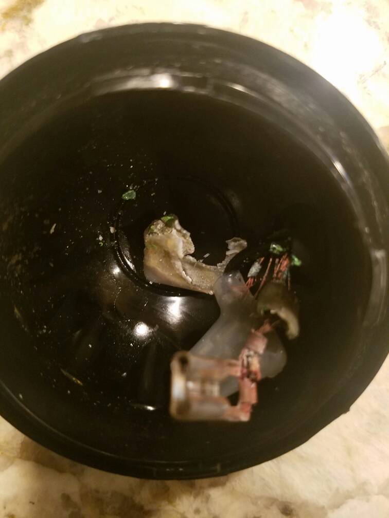

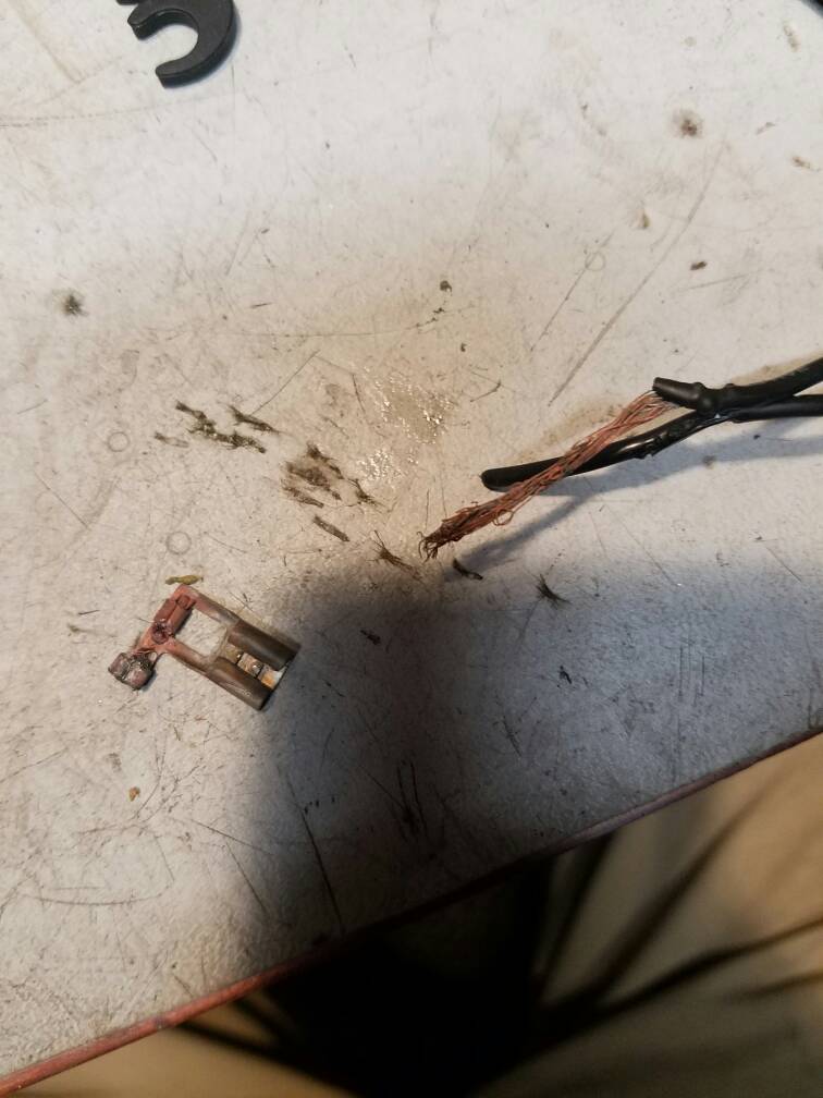

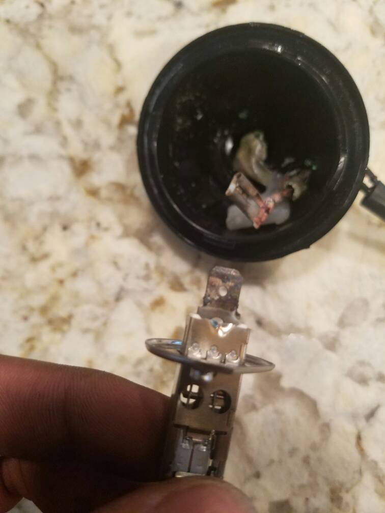

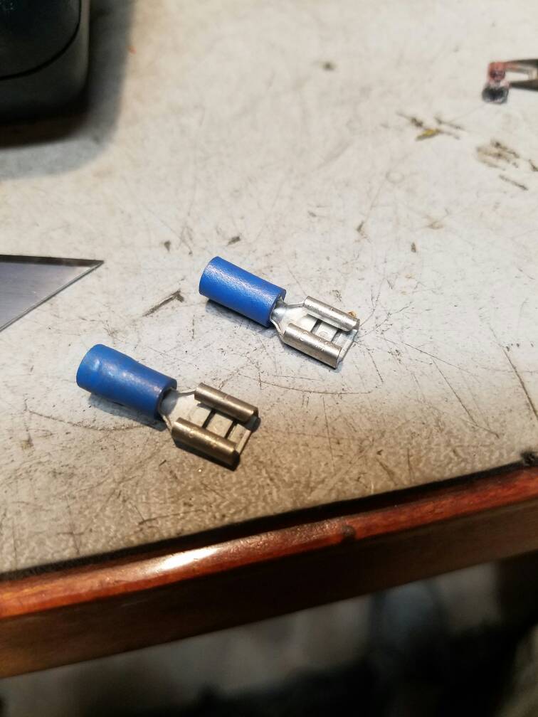

Not exactly sure what caused this or how, but this happened to my driver headlight about a month ago and about a week ago to my passenger headlight. Big pain, having to replace all the wiring and connectors on practically brand new headlights. Ive gone through two bulbs on both sides and have no idea why they keep getting burnt up like they are. Extremely unsatisfied with these headlights

What on earth just happened there...man.
Assuming you did purchase these through us, email customercare@procivic.com and we'll help you figure out what is going on. Personally, whenever I do any electronics install, I always use a multi-meter to test current and voltage, since one small short can cause overheating issues like this. The short can come from wires not being connected properly, or part of the headlight wiring (or the bulb) could be defective as well. Sorry this happened to you!
Yes, that could definitely cause a short and overheating as well.
It happened to the first headlight within 2 weeks of them being installed. I havent seen any moisture built or anything in the headlight
