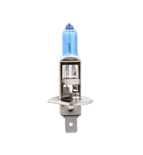

Thank you! They are ordered. One thing I am confused about. Yours have the connectors on the end...The ones I ordered look like the picture below. Is that just how the h1's are or what? Just wondering if I'm going to need to order an adapter.
headlight must have some type of connector to go from h1 to a 9005 connector. I'd imagine the back has a connector like this for the h1 and then it goes to the stock wiring adapter. I've not see the wiring on those aftermarket headlights.

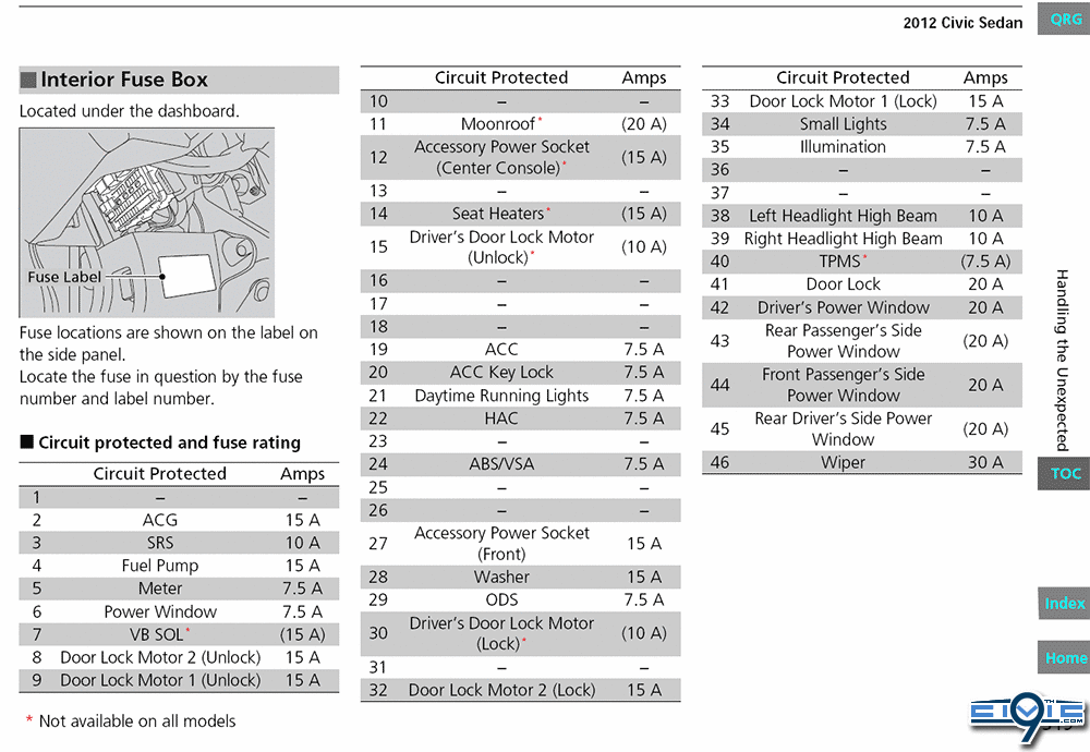

@Joe Liu Here is a screen shot of the 2012 model. The fuse box diagrams are almost identical if not identical. I know the Small Lights fuse is the same. The fuse would be labeled as Small Lights (Number 34). It is in the interior fuse box.
