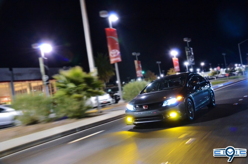

I'd just use a nokya or similar bulb for the high beam personally. If you go with hids in the fogs, it's common to run 3000k hid bulbs in them. 3k bulbs cut through rain and snow much better than a standard hid bulb. They'll look like this yellow fog below -
