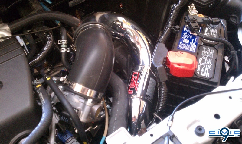

    This was their original CAI made for 9th gen Version 1
    [​IMG]
    [​IMG]
    The air filter was sitting very close to radiator so instead of getting cold air your engine would get hot air.

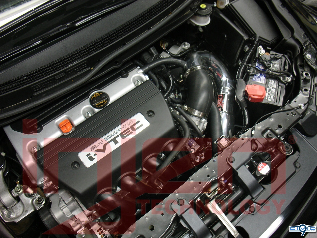

    Last year they released their another CAI version 2
    Majority of the people buy PRL or Skunk2 CAI. Vit recommends PRL cold air intake

    @Michal006 i knew of the old version and about the hot air issue. just very curious about what the gains would be like compared to the skunk2 and prl only because theyre very close in design. stock manifold kit from prl is 399. this one i believe in 329, and skunk2 not sure. just trying to figure out the best price per horsepower. otherwise i might just design my own off the PRL kit. Do you know of anyone who has this intake installed and tuned

    Looks very similar to the same kind of intake available from PRL or others, but knowing Injen it's only 3" while PRL is 3.5" and cheaper.

    I would stick with the PRL since it is 3.5", more metal than silicone tubing, and comes with a SS clutch line. Plus PRL's battery tray looks more solid.

    @chacky09 from my understanding its an intake that performs very well. Its been proven it doesnt make the most power and or peak hp/tq but definitely a good intake. Well renowed in the 8thgen community. As for designs/max power Injen V2, PRL CAI, Skunk2 CAI, and Rick Spec'd are all close in design and would more then likely yield the same ball park numbers. PRL/Rick Sped'd on the higher end and injen/skunk2 on the lower end.
