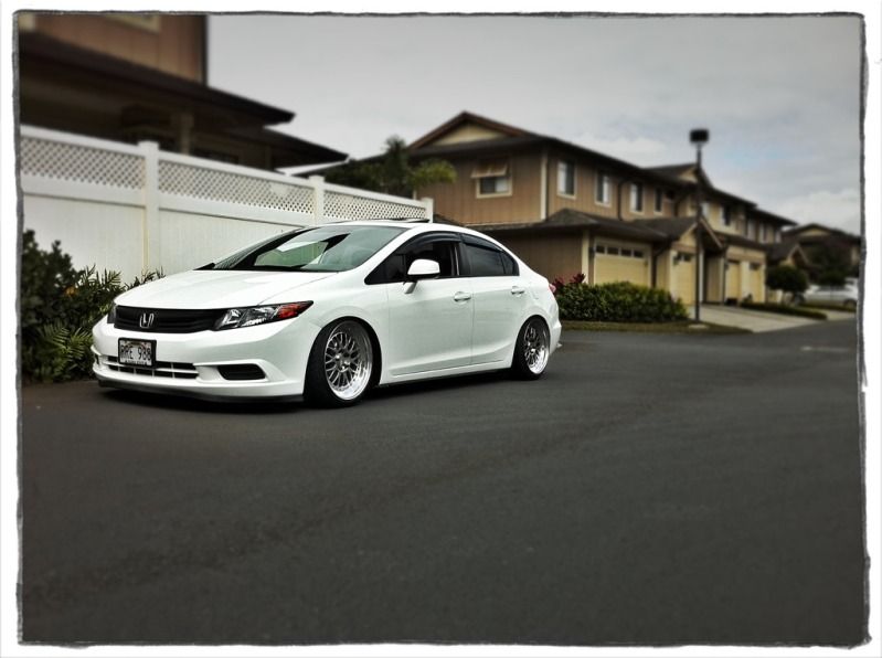

Well im not worried about the sizes, I want to sit flush again, but ive always used a x9 instead of a x8. so my main concern was doing a x8 all around with a higher offset to get it to look like the x9 +27. and I would drop it on the coils with 205/25 or 215/45
my works were on 215/40/17s and i was low and scraped my subframe on my speedbumps in my apt complex...if I do the 205/45 ona x8 wheel, ill have a tad bit of stretch, and i can lower some without messing up the SF...i just want it to still be flush with the specs being 17x8 +20

To get an 8-inch-wide wheel to appear the same on the outside as a 9-inch-wide wheel with a +27 offset, the 8" wheel would need a +14 offset. It will not look the same, though, because you will lose an inch of width from the inside and it will look weird from any angle that you can see the back side of the wheel. If you don't want to scrape your subframe, you're going to have to raise the suspension higher than what you had on the coupe you posted a picture of. Also, unless you're trying to get the car as low as possible, I would recommend the factory 215/45-17 tire size on anything up to a 9" wheel. I've seen smaller tires stretched onto wider wheels, but I don't see the point. It doesn't stretch the sidewall anymore at a certain point, it just makes the wheel poke out of the tire more. I had 195/45-15's on my 15x8 Equip 03's and it was barely stretched at all, but stretched enough that I had no protection from curb rash at all. It was stretched enough that it looked good, but not so much that it went beyond any fashion or function just for the sake of seeing how small of a tire I could fit onto a wide wheel. I did it purely for fashion, so I wasn't worried about getting close to stock tire size. Had I been worried about that, I would've gone with a 195/50-15. So, for anything up to 9" wide wheels, I don't see any problem running the stock tire size. Running anything smaller, unless you're just trying to slam it as low as possible, would be pointless as well.

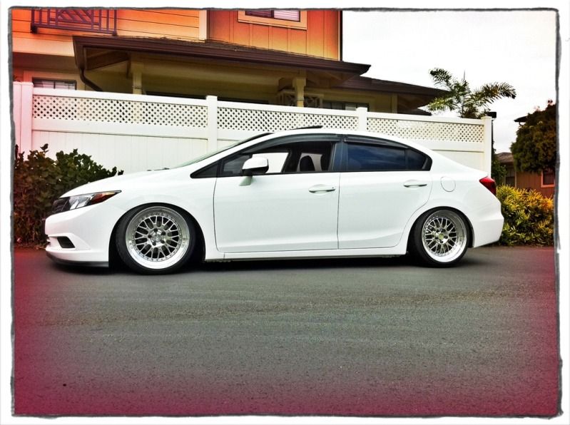

this is 8" wide with a 30 offset/stock suspension in pics. Lower than 30 on an 8" and you're going to be poking out. Lowered on this and you'd probably be rubbing without rolling fenders.
g35 wheels.
18x8 30 offset

Well that coupe in that picture is my old coupe and i didnt scrape on that setup at all. I was just thinking a x8 +20 with a 205/45 would somewhat match that look and sit decent. I had no issues with the x9 +27 at all, no rubbing or anything, although I had the rears rolled but never touched the fronts what so ever. Im not trying to slam the heck out of it, but only using that pic as a reference cuz I want to be that low on this 9thgen and have it look functional and decent, but wasnt sure if I could achieve that goal by not going so wide.
+20 would put you basically a half an inch wider than what his rims are here... that what you're looking for?
hmm...yeah but its going to go in once its lower, and that one dude on here is running a x9.5 +23 on those battles and he didnt roll fenders at all
