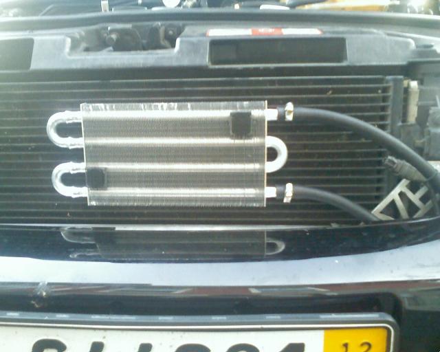

You're just heating up the fluid a lot. Change the fluid more often, I do a drain/fill every 15k, and you could also look into a transmission fluid cooler. Just a small radiator unit that goes in between the lines.

For an auto trans fluid cooler the Hayden 401 is a nice small radiator. Just use the fluid return line and put this in front of your radiator.
http://www.summitracing.com/parts/hda-401
