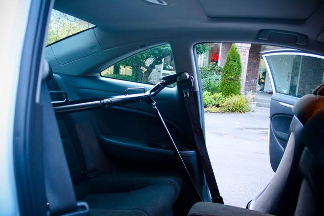

This was an 8th gen harness bar. You can see that this one bolts into the stock seatbelt mounting locations. Which is where you want any type of bolt in "cage" to go.
Anything that bolts to the floor and not the stock mounting points will tear right out. Those areas on the car are reinforced heavily to withstand crash forces. I know you aren't planning on running harnesses, which is smart, but bars that bolt into the floor pans in the rear with anchors are not mounted properly. Even with large floor anchors the steel in those areas is not thick enough to stand up to the forces experienced in even a low speed crash.
Also, since you want this for looks, notice that the bar really isn't visible from the outside. This is how most "ricer" harness bars are.
Honestly, for the cost and the low visibility, skip it. Just my 0.02 on that.

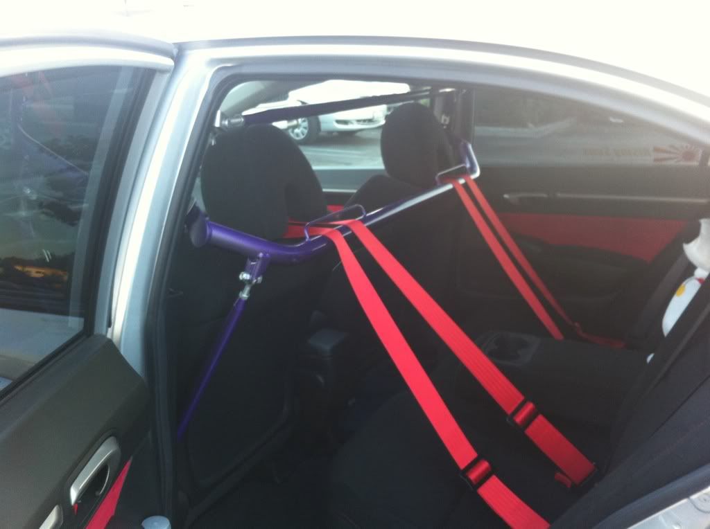

Heres another similar setup with straps run: Run this and prepare to die. Or at least have your spine compressed and suffer severe debilitating nerve damage.

Just remember these are racing safety systems. SYSTEMS being the key word. They are for the track in conjunction with other safety measures designed to work together. They are not made for the street. Stick to the OEM safety equipment.
Stuff for the track is for the track. Race stuff is for racing.
Rice is Race Inspired Cosmetic Enhancement.
Don't mix them. You will be injured or die.
