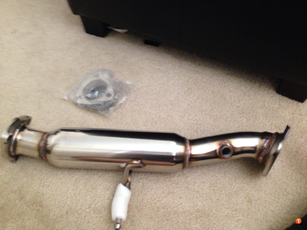

Best picture I could find to explain it.

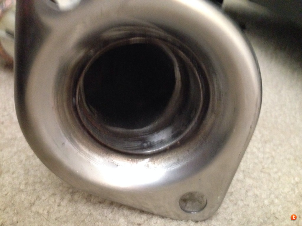

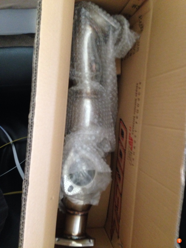

Looks fishy ... Its sticking out of the box??
Just bubble wrap? No insulation ?
No inside weld?
Damaged?
That's how mine looked and installed with no issue.

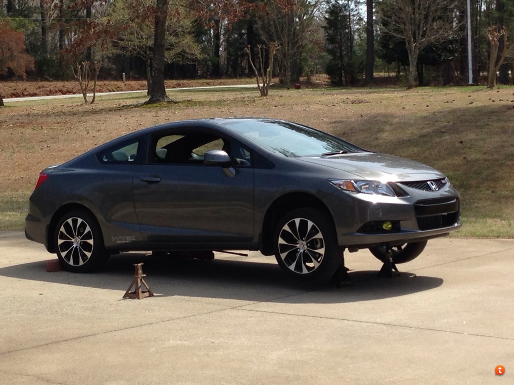

Why does the exhaust have to get hot so fast but cool so slow .. Now all i can do is wait ...
