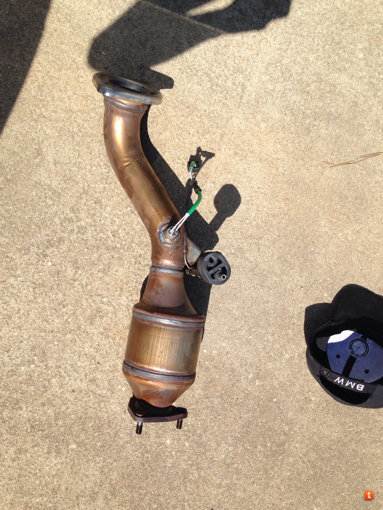

Yes. I have the skunk2 alpha header and the thing is deeper. It gets rid of both cats that's why.

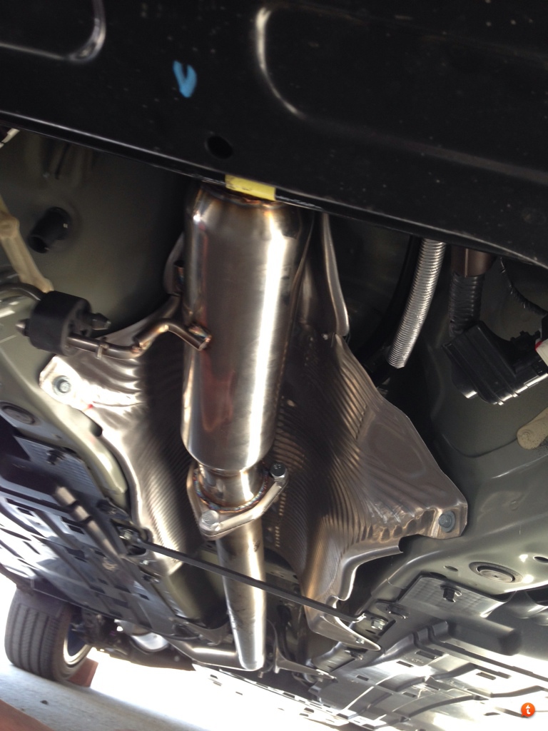

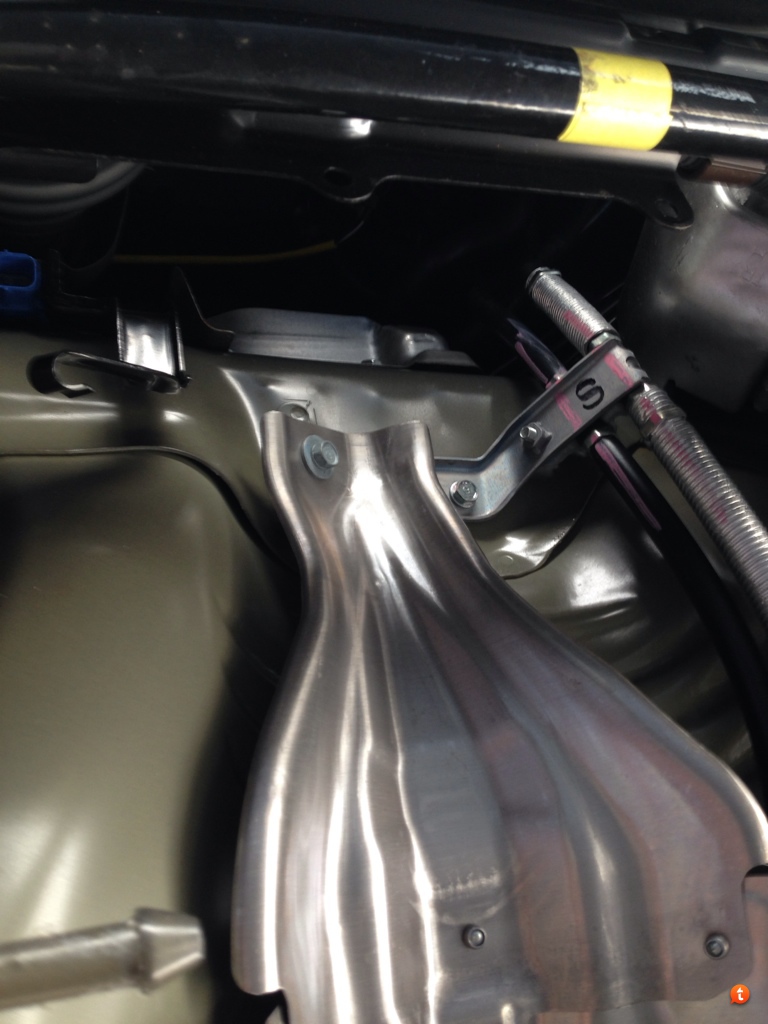

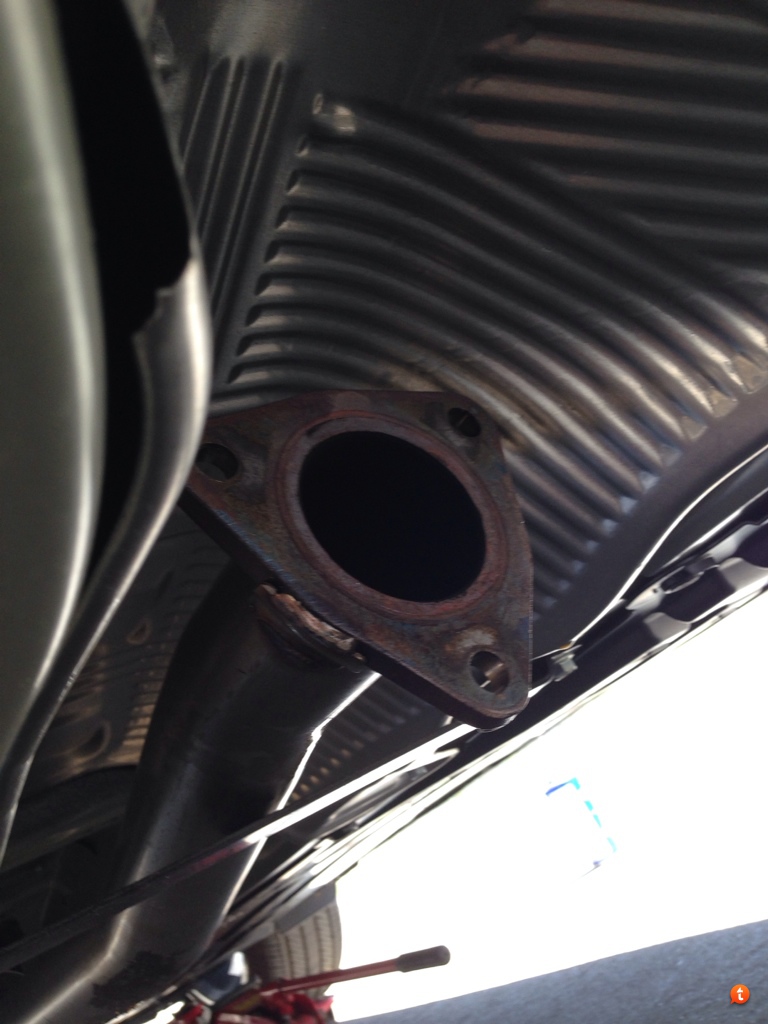

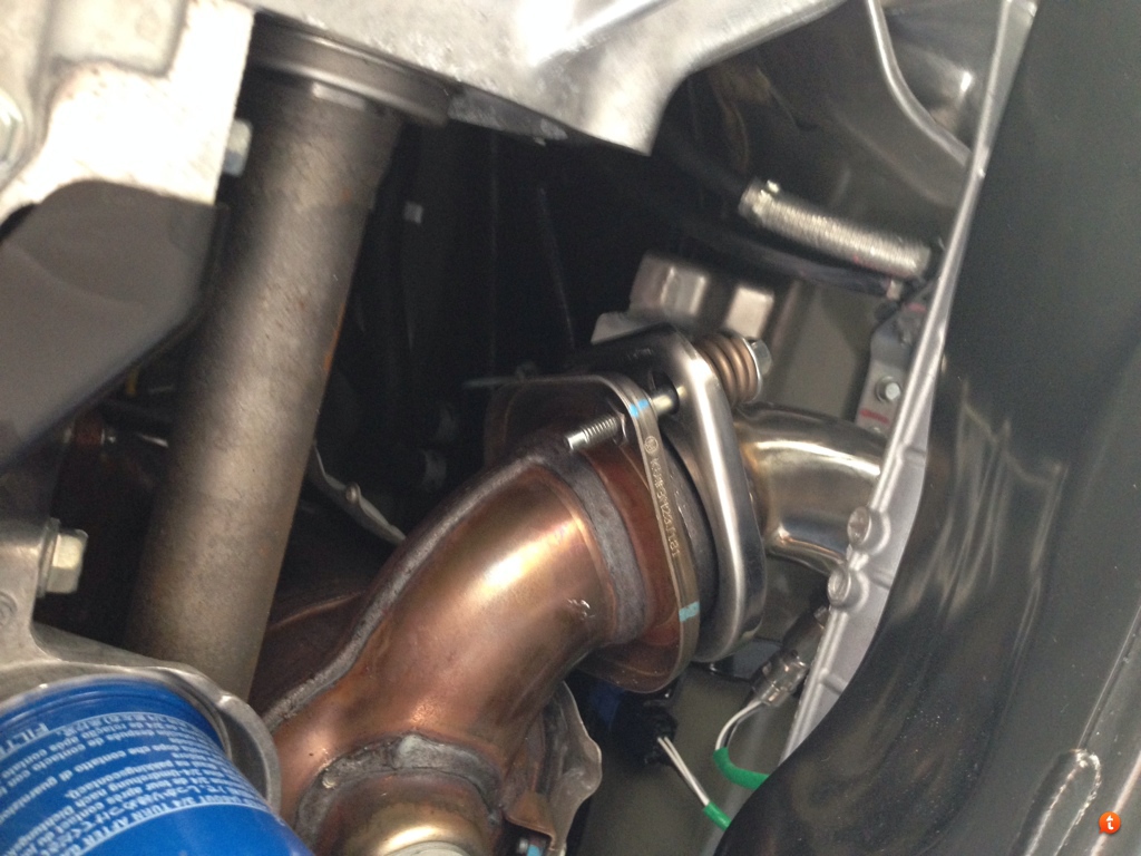

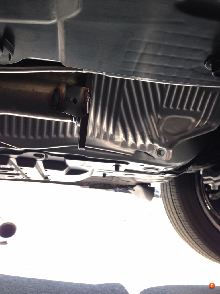

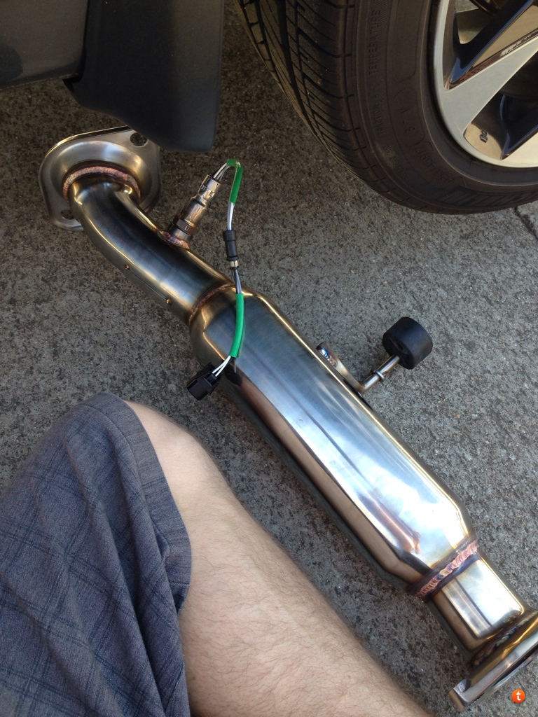

Hey man i just tried installing mine today and the bolts they gave me did not fit neither the stock ones from the carIt was on the install that it broke. I think i may have made the ultimate noob mistake and cross threaded the bolt. thankfully after hours of hard work and busted knuckles and scratched hands , the pipe is finally in. She is a slight bit louder. Accelerates a bit better. It also got rid of the popping sound in the factory exhaust. The pipe fit perfectly and had all the gaskets and hardware that was needed.
View attachment 28634 View attachment 28635 View attachment 28636
The last picture mine did not fit on my 2015 si need to use stock one and I need bolts because the bolts it came with were to big and the stock bolts the springs to long kinda bummed out I couldn't do it today but I'll fix it latter I just put the back everything together![]()

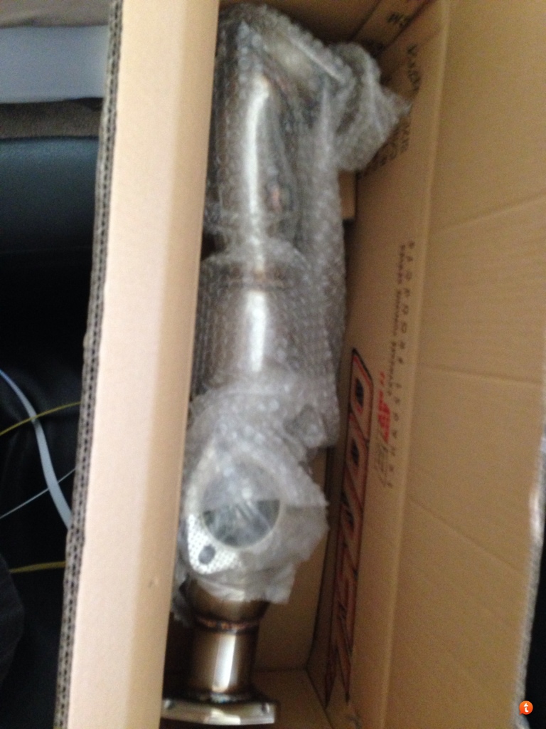

Looks fishy ... Its sticking out of the box??
Just bubble wrap? No insulation ?
No inside weld?![]()
Damaged?
