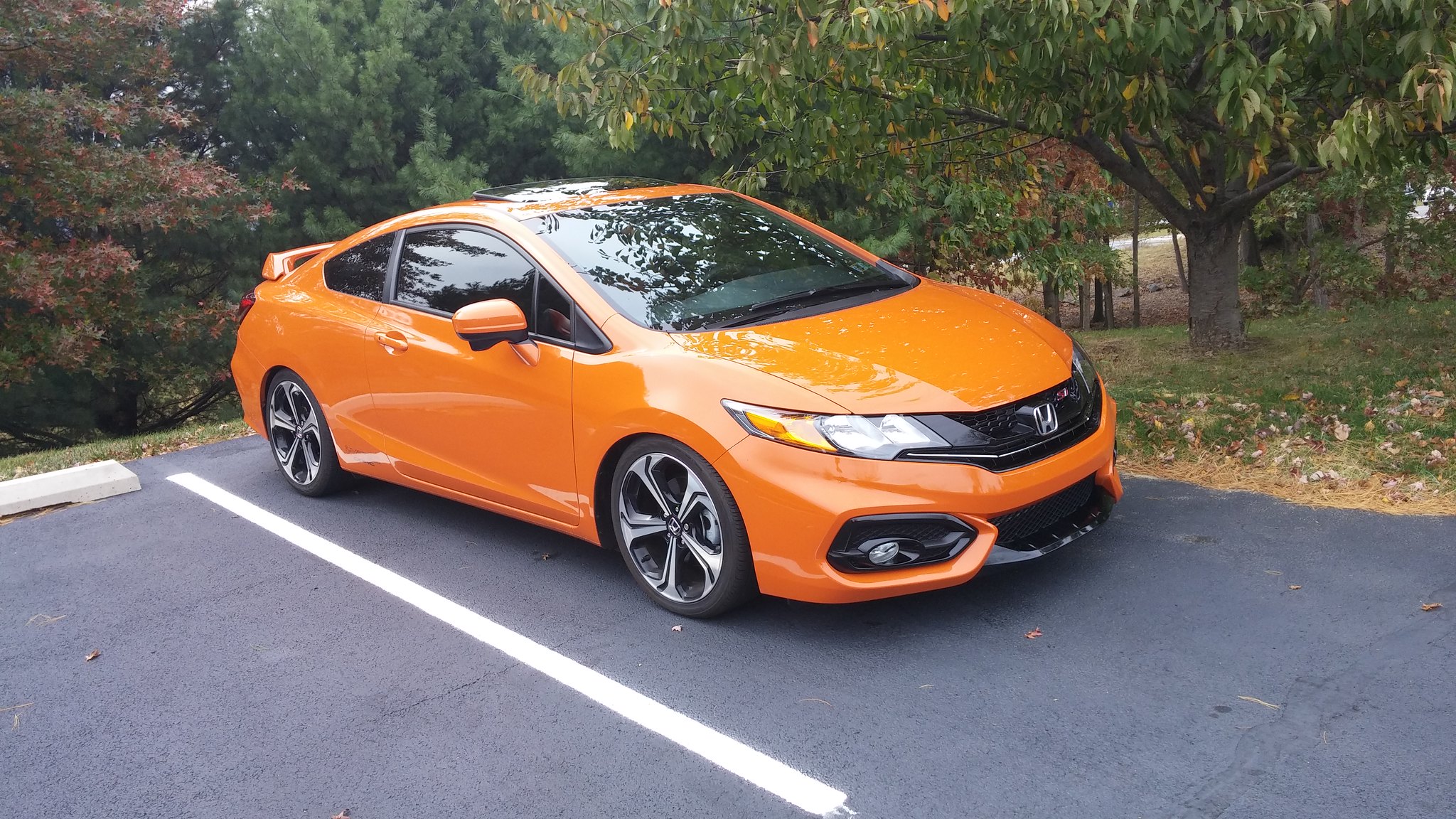

This was my car on Eibach sportline springs. It was clunky on every little bump on the road, now I'm back to stock ride height.
Nope, but the inner fender clip that's in the middle is now gone.
