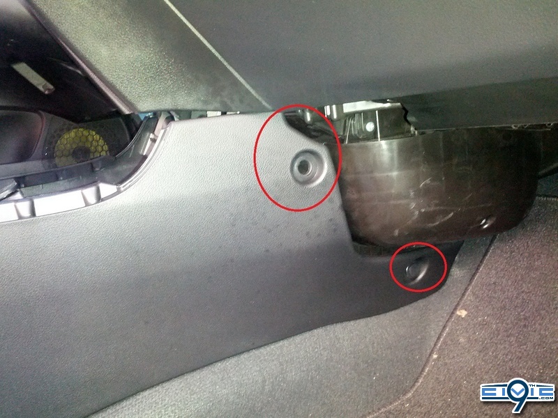

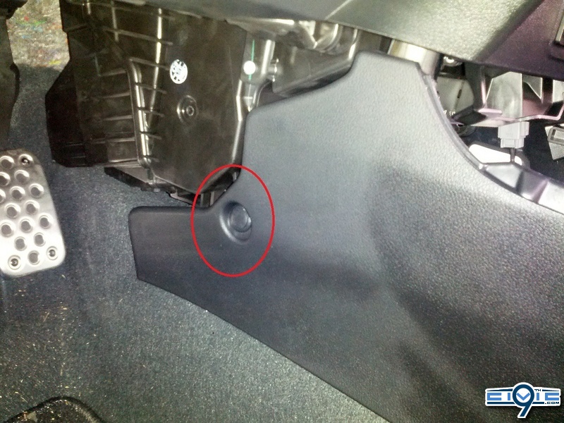

Awesome write up, thank you for taking the time to do this. I would like to add one thing that worked out really well for me to get these plastic push clips out.
I placed a 5/8" socket over top of the clip (the ring sits nicely on the edges of the socket) and pushed with my finger from the backside of the clip. It popped out real easy. No marring of the the panel or clip!

No problem. Thanks for adding the tip! It will also help reduce the possibility of breaking the clips.

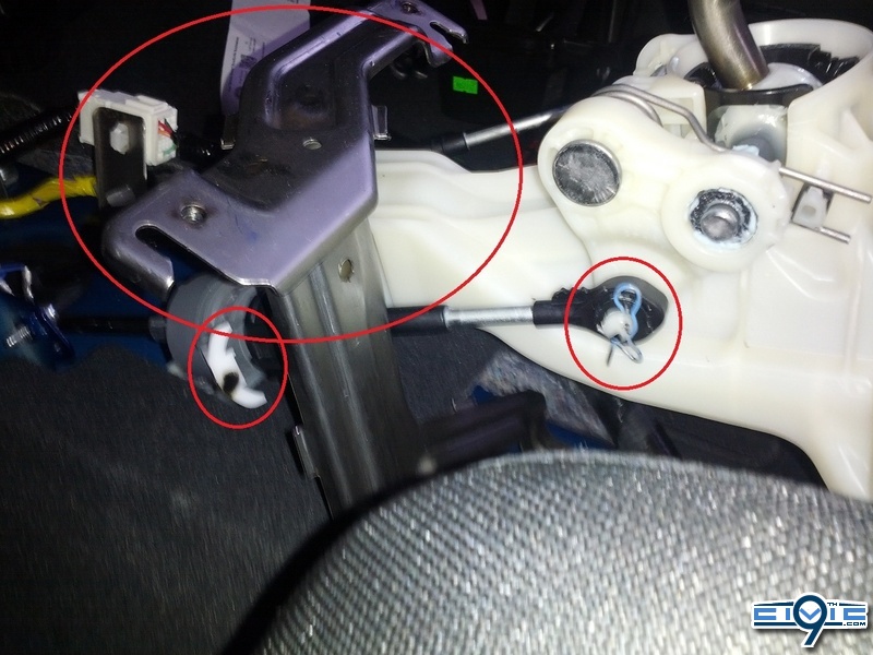

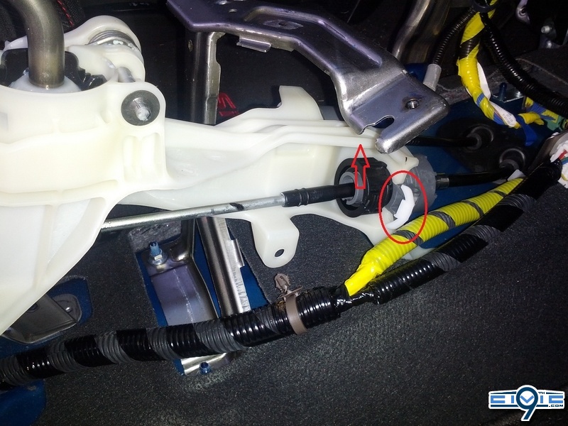

Squiggy or anyone else who did this mod...
Could you guide me through the process of removing the the shifter cables as displayed in the pictures below?
I tried to do this as described in the steps from this great DIY.
- move away white plastic piece
- rotate spring loaded black piece (HOW MANY TURNS?)
- slide out shifter cable (HOW DO I DO THIS?)
This seemed difficult to do and I didn't want to mess anything up so I stopped. Everything seemed real snug and the cables seemed real tight from the floor to the white housing. Do I have to worry about the black piece rotating CW after I get it off?
Thanks for your help. I have stopped installation until I feel confident (through your replies :) ) I will not mess anything up.

A LOT of turns. Keep turning it and it will eventually be easy to slide out towards you. The black peice will return to its original position once you let go of it. You will have to turn it to loosen it again before you put it back on, but that is not a big deal as you can hold onto both sides.
