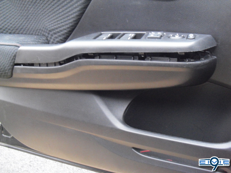

Step 1: Remove Door panel (Driver side) only 2 screws, 1 behind the door handle and one under ur window controls and then pry ur panel off.

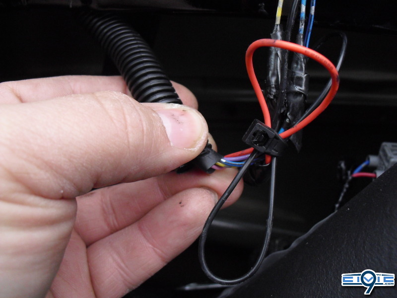

Step 2: Remove the plastic covering to expose yoor wirw harness and mirror screws.
Step 3: Remove your mirror 8mm socket and wrench with extender and remove the 3 lock nuts becareful to not lose them.

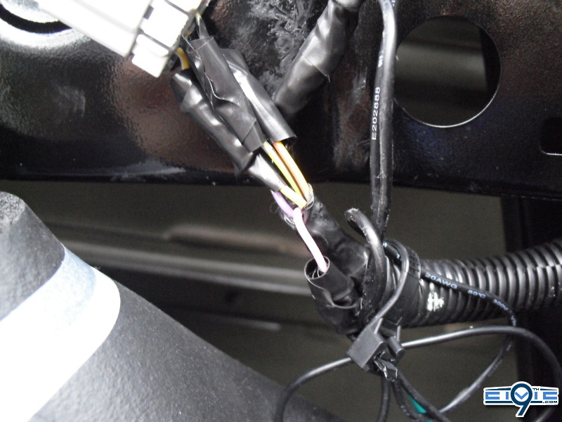

Step 4 : Wire Your Hybdrid mirrors Driver side will be (Yellow-Red, Yellow-Silver, Yellow-White) these are for powring your mirror, Signal Light(Purple- Negative, Light Purple-Power) Negative should be touching a good spot of bare metal of the door. You can splice the power with your front and rear signal light

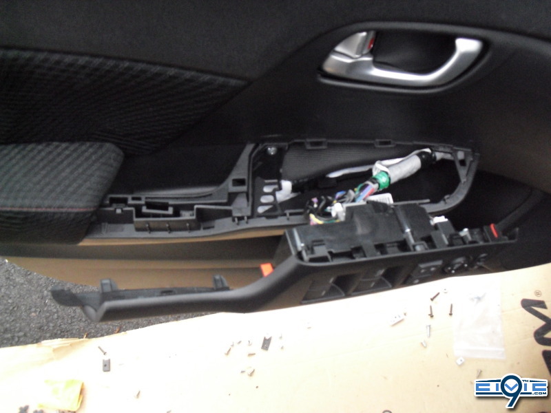

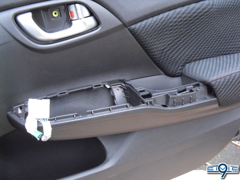

Step 5: Remove Door panel (passenger side ) Reapeat step 1

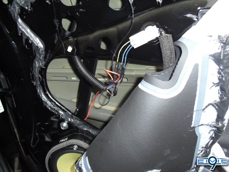

Step 6: Repeat step 2
Step 7: Repeat step 3
Step 8: Wire your Hybrid mirrors passenger side will be ( Yellow-Silver-White, Blue-Silver, Blue-black) these power your mirror, Signal Light (Purple- Negative , Light Purple- Positive..
Step 9: Check your work and make sure signals are working , if not check Purple and light purple wire and reverse, You will not blow a fuse if wrong from my experience cuz i have already done it and then reverse it myself.

Step 1:
Step 4:
Step5:
Step 8:
