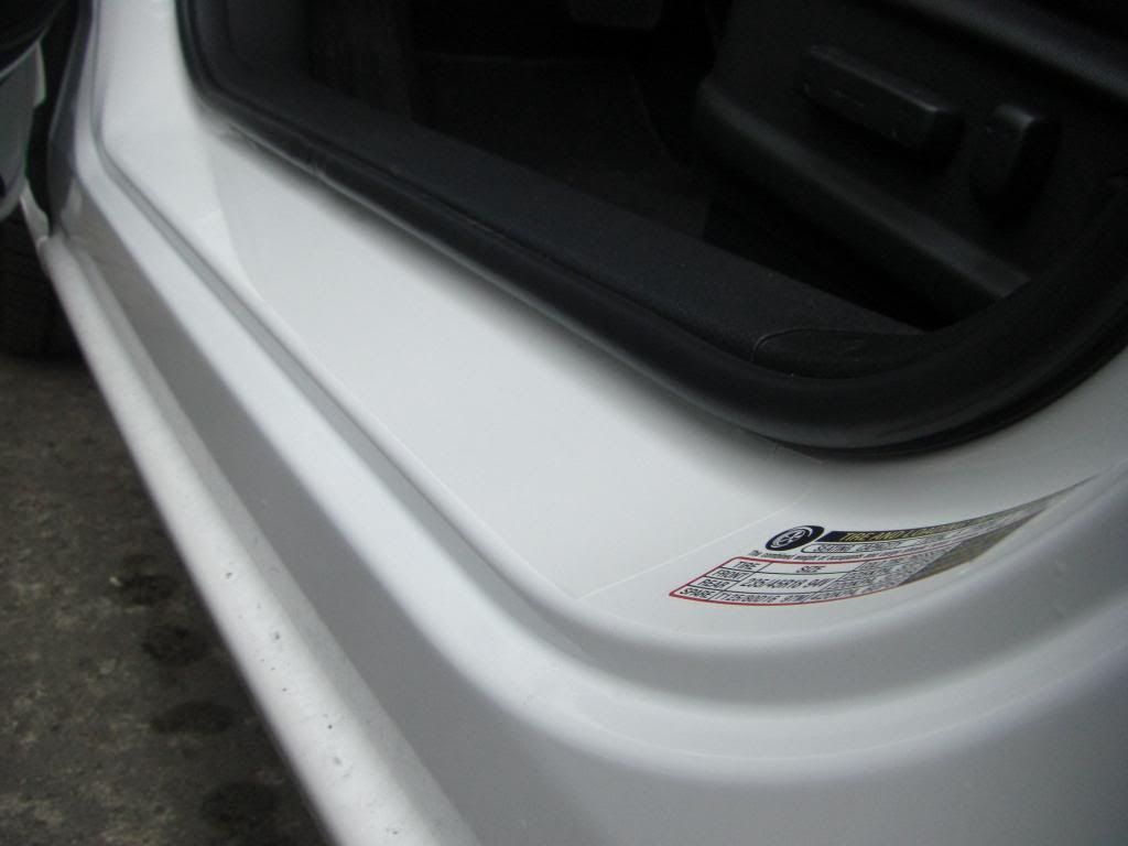

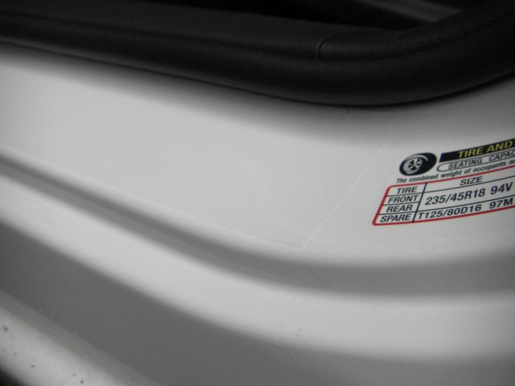

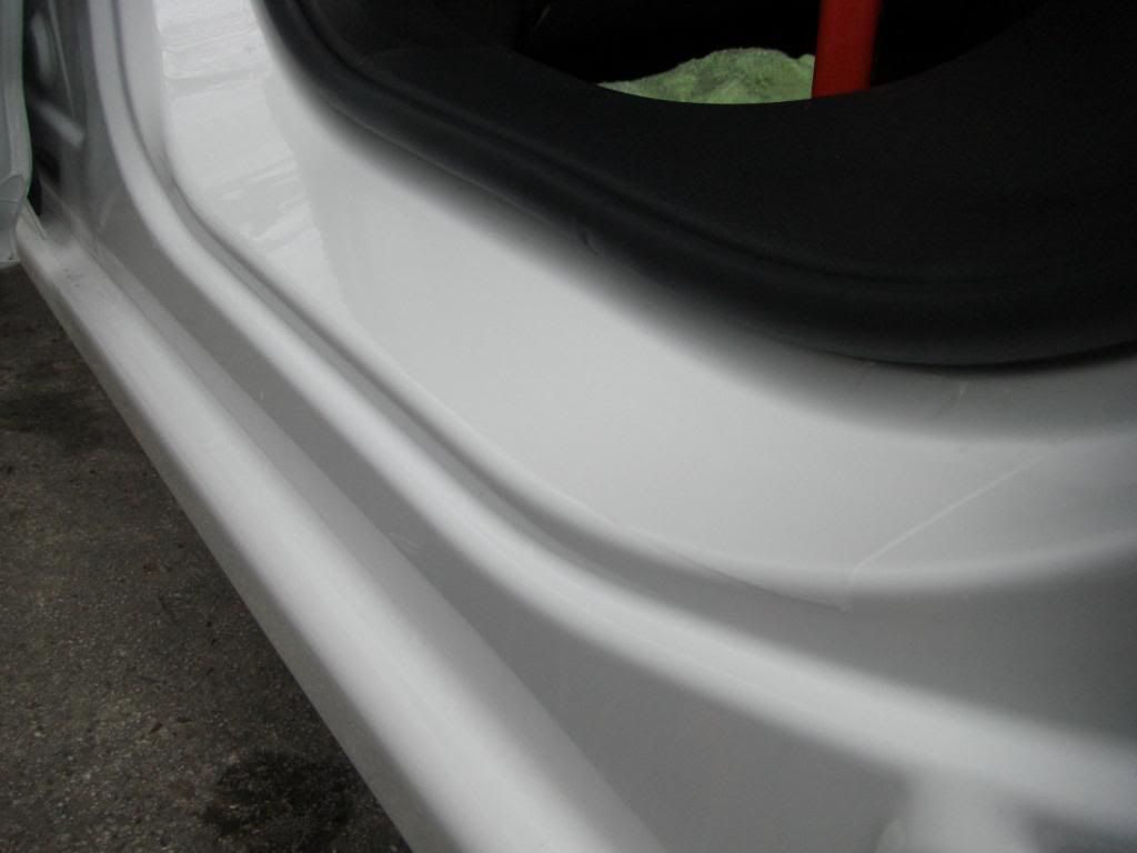

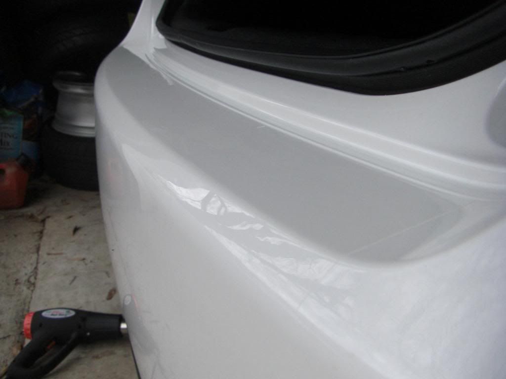

Webby hooked me(for a decent price :giggle:) up with some Ventureshield clear vinyl. Sent me 4 pieces for the door sills and one for the rear bumper.
Applied each section by cleaning up the area and doing one pass with the clay bar. Then cleaned again and sprayed soapy water before laying down the vinyl. Squeezed out the air bubbles with my finger as best as possible then heated a 3-4 inch section at a time. Once heated, I squeezed out more air bubbles then moved down to the next 3-4 inch section. I started in the middle and worked my way outward on each piece. The rear door sills were the hardest to do but on the drivers side rear door section was cut it a bit shorter compared to the pass. side and applied it a bit further to the front of the car. This made it easier to apply and turned out better.
It was a bit tough to get the pics to come out right.
Trunk
Drivers side door
Rear drivers side door

I think I am going to use the leftover vinyl and cut strips to cover the section where the door weather stripping touches the body. Seems to always get dirty there.
