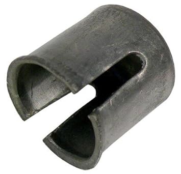

If the post clamps on your battery are loose you may need to pick up a couple shims. I know auto zone has them. They look like thimbles but are lead and you can slip them over the posts. They should have cuts in the sides so you can break them in half if the full size is too much.
EDIT: They are soft and made of LEAD. So don't play with it too much!
They look like this:
Thanks Nix! Yes I was looking at these the other day, Im going to pick up a set today!

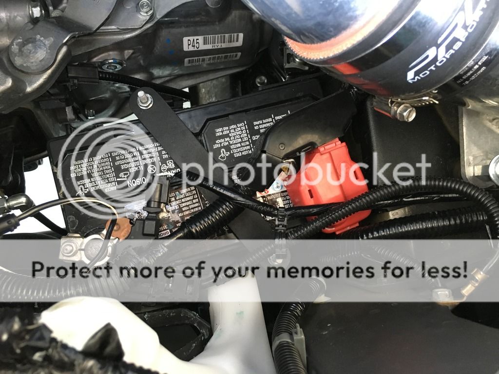

Ok thanks I appreciate the info, Im going to do this tomorrow I already bought the shims, yeah the negative rotates and the positive wiggles a little with the extention PRL sent me.

Thanks everyone! I did end up tightening everything down, I ended up removing the prl extension on the positive side and put a shim on that side now but connections are nice and tight! I really hope this was my issue...

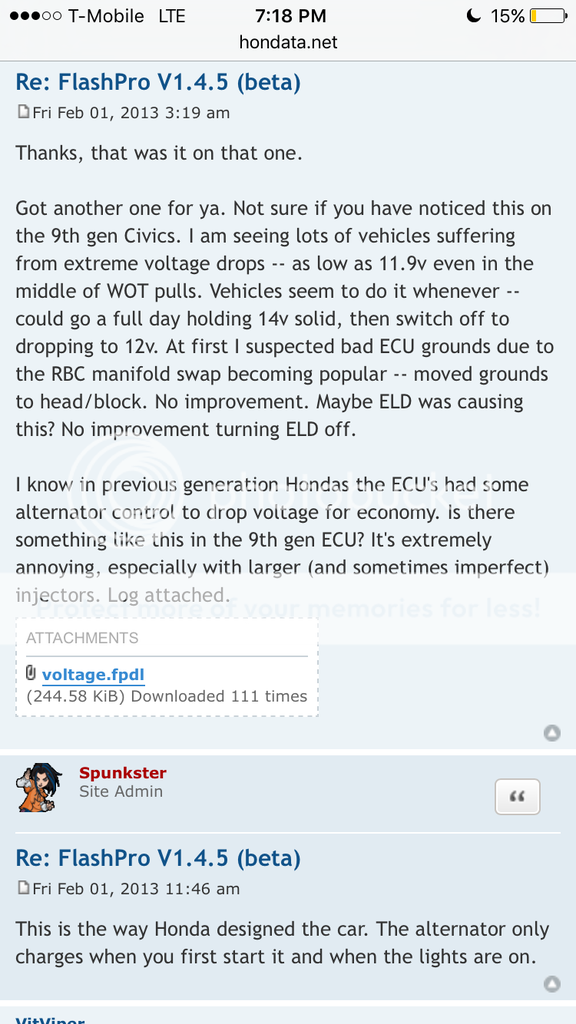

So the car has felt fine since I thighten down the battery connections, but my flashpro keeps showing me a voltage fluctuation while drving for example, I took the car for a drive today, and sometimes while I was driving the car would be between 14.0-14.3 volts while in neutral and while in gear giving it gas.. But sometimes it would go down to 12.1-12.8 while in gear and giving it gas, and it would slowly get back up to 14 at a red light, but sometimes it would stay at 12.3-12.7 at the light and even after putting the car back in gear and the again while in gear it would climb back up to the 14.3.. Oh and another thing I noticed is with the a/c on (the fluctuation would happen with ac off) with would stay at the 14 range and not go down any lower.. So my question is, is this fluctuation normal while a/c is off and driving? Or whats going on? Everyone says the battery and alternator are fine and Ive never had any starting issues.

I think I will contact them to see what they say, its weird though since the terminals are now connected directly to the post on the battery very tight.. Ive been doing aloooottttt (yes almost all day) of reading and came accross this

I'll run my OBDII app and watch my battery voltage but I have never seen nor heard of a car "designed" to drop bellow 13v. I would suspect your alt is having issues if it fluctuates that much. I swear I've had my battery voltage show on the app for the few weeks I used it and never saw less than 13.5v but I am stock still with no system.
A good battery runs at 12.66v "ideally" at 100%. 12.1v is starting to get in the "ruh roh" range, but I'm not a honda expert so it may be that way so like I said I'll keep an eye on mine for a few days.
