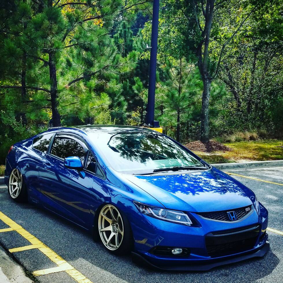

Here's my car so far

Good luck man. Your car is clean AF.
