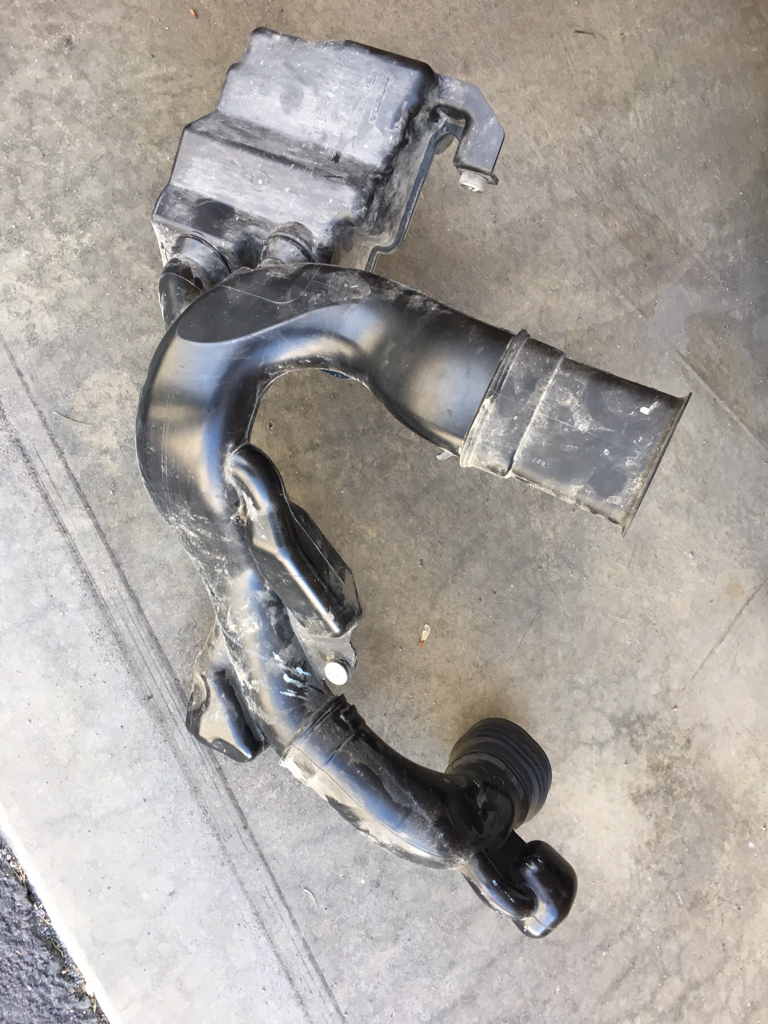

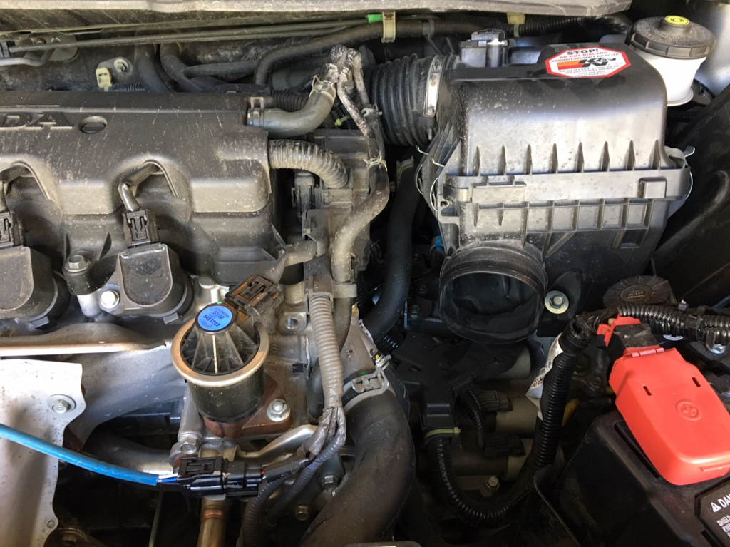

After much deliberation, I sold off my Tucson and the civic became our only car. So step 1 was to get rid if the Resonator. Did that today morning. However, I have a doubt - will this setup not suck in warm air from the engine? Do I not need a air filter like the K&N 69-1020TS or the Takeda TR-1020B to compensate for it? Also will they work without wrecking the existing performance? I don’t want the car running leaner....
It looks like you have a k&n drop in filter based on the sticker there? You should notice a slight difference with just that in performance and sound.

Yeah webby, I do have K&N drop-in. I do hear better sound... performance not sure. What I am worried is, if this setup without the resonator is worse as it may suck hotter air from engine bay....
52,105
22,314
It’s really no different from a short ram aftermarket intake. Yes, it’ll be warmer air in sit and go traffic. Once you’re moving, it’ll be getting better airflow just as it would with the oem snorkel attached.
