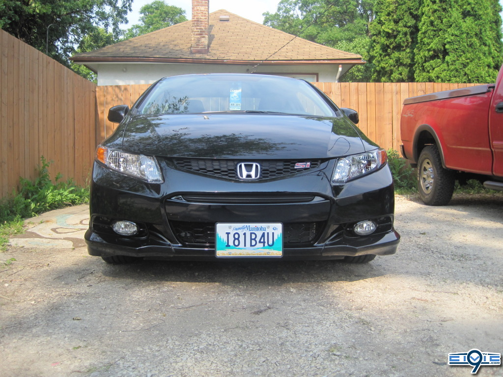

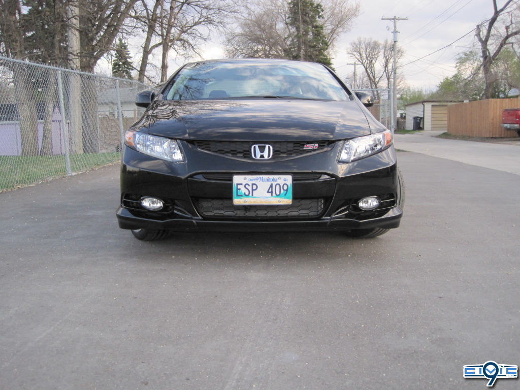

Where i live it is required by Law to run a front licence plate, so the dealer installs the front bracket on the car prior to delivery.
In my case the plate was mounted in the middle of the front bumper as you can see below in the picture.
So what i have done is removed the plate (4 bolts) and underneath the plate there is a single phillips head screw
in the center top, and below there are 2 - 10 mm bolts that hold the bracket to the bumper. once these are removed you will have the front bracket free and clear of the vehicle.
I tried to just use the bracket upside down with the same bolts but the bolts are just a 1/2 inch too short so i had to replace them with a couple of bolts that were a little longer and i also used a couple of washers to make sure that the bracket didn't come off inadvertently. Now i didn't put the screw back in, it would go into the bottom lip and i didn't want it to make another hole so i just left it mounted with the 2 bolts, guess the wind at speed would force it back but so far i don't hear any noise or rattling from the front and after a week of running the plate that way there doesn't seem to be any marks or scratches on the bottom lip
i didn't take any pics during so all i can offer up is the after photo

I think it looks way better! Can you take some close ups of how you positioned the bracket?

yes they drilled one small hole into the bit of trim above the bumper, and it was positioned in the factory holes just upside down
