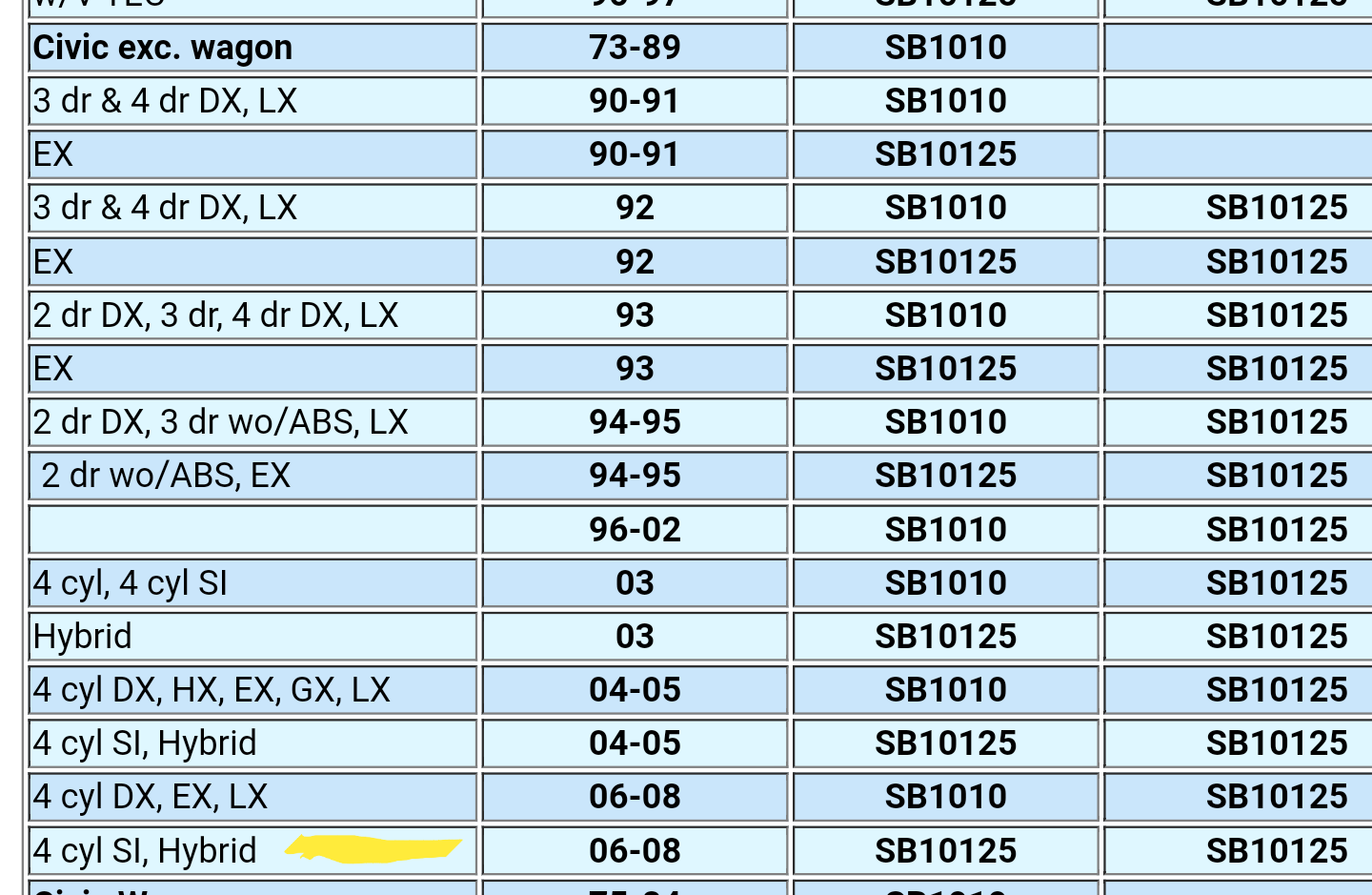

To those looking to do the speed bleeders, after comparing part numbers I found that our brake calipers (9th gen Si, likely the other trim levels too) do not use the same bleeders on all 4 calipers like the 8th gen Si (and other trims?) does.
Our front bleeder screws are Honda part #45215-671-672 (M10 x 1.0 x 34.44) - the same as the '08 element (and many others... 4 cyl Accord, etc.). Our rear bleeder screws are #43352-SM4-951 (M10 x 1.25 x 34.44); these are the ones the 8th gen uses on all 4 calipers. Our civic uses the same clutch slave cylinder bleeder as the 8th gen, part #43352-567-000 (M8 x 1.25 x 32.54).
Speed bleeders:
https://www-speedbleeder-zoovy-com....qqgkW/s=www.speedbleeder.zoovy.com/category//
F: SB1010
R: SB10125
C: SB8125L
Front……SB1010
Rear…….SB8125L
Clutch….SB8125L

@webby @trustdestruction quoted SB10125 for the rear Speed Bleeder part number when in fact it should be SB8125. It looks like it's M8 not M10. Only the front is M10.

I'm reviving this thread because the information is not correct for my 2012 Si Coupe. I ordered the same part numbers provided. My rear bleeder screw is definitely M10, I just haven't gotten a hold of anyone yet at Speed Bleeder to confirm what the actual size is.
For my 2012 Si, I believe trustdestruction was correct with
Have to say I'm perturbed by the incorrect information. :banghead: Thank God my Civic is not my daily driver anymore.

If you put
45215-671-672 Into rock auto it says m10-1.0
If you put
43352-SM4-951 Into rock auto it says m8-1.25

If you put
If you put
Thanks for the quick response, Webby.
I'm really thinking this is wrong. The rear bleeder screws are the same diameter as the front Speed Bleeders, which are M10.
I haven't heard back from anyone at Speed Bleeder. I called and sent an email. I'm just going to purchase the ones that Trustdestruction suggested, and try em out. I need to be done with the brakes by next Saturday so I can do the break in before my 2/28/20 track day!

Hmm, looks like rockauto may have led us astray.
Looking at the speed bleeder website, it might be m10x1.25 front and rear? They don't have an application listed for 9th gens but the 8th gen is showing sb10125 for both...

When you pull a Honda part # it’ll show applicable uses, and it shows each part only works with front or rear and not both. I don’t know how they differ, but they are different from front to rear in some way.
I tend to agree here. The more I research the more confirmations I'm getting that the front and rear are different.
Other than @Civi9 stating the part does not fit, I would think the cross reference we did originally is correct.
@Civi9 did you physically try to install the bleeders and they were too small?
Sent from my SM-G920V using Tapatalk
Yessir! I pulled the rear bleeder screw out, and went to thread the M8 Speed Bleeder. It almost fell into the caliper, it was so much smaller! lol....
I'll take a photo tonight of the rear bleeder screw and Speed Bleeder side by side. In fact, I'll take a photo of the front Speed Bleeder next to the other two, for further comparison.
