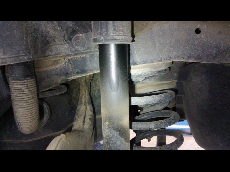

I can’t check em out right now but Honda told me last fall that it looked like they were starting to cup but it was end of season so I put winters on. Drove on them this year and it got worse, took them to where I bought em and they said the tires are all showing “inside shoulder cupping”. The main problem was noise driving anywhere was obnoxiously loud.
The shop I got new tires from told me my back shocks are going and showed a picture. I believe that could also be an issue.

Yea that looks like it is leaking some. You could get some carb cleaner or something (even soap/water) and clean that shock off really well and see how it looks in a few days, but I’d imagine that staining is the shock leaking.
