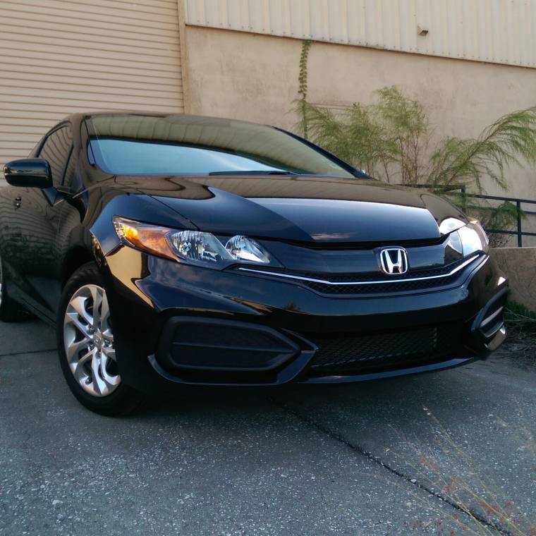

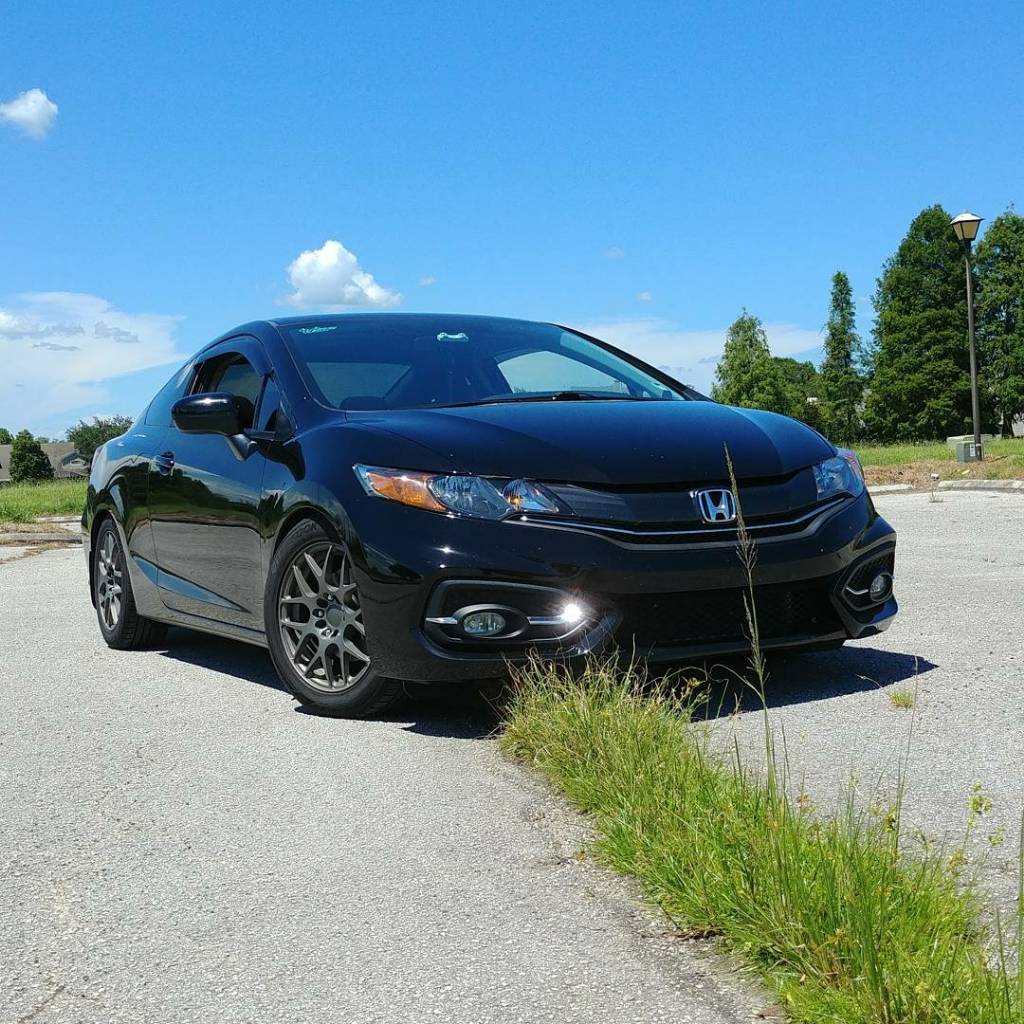

This is my '13 LX on Skunk2 springs, which is 2" rear and 2.25" front. Mine also came with 15" wheels, but it's on 18" Si wheels now.
Before:
After:
Hm. I guess the 12-13 came with 15's on the LX. Didn't know that. Mine came with 16's just thought they all did.
