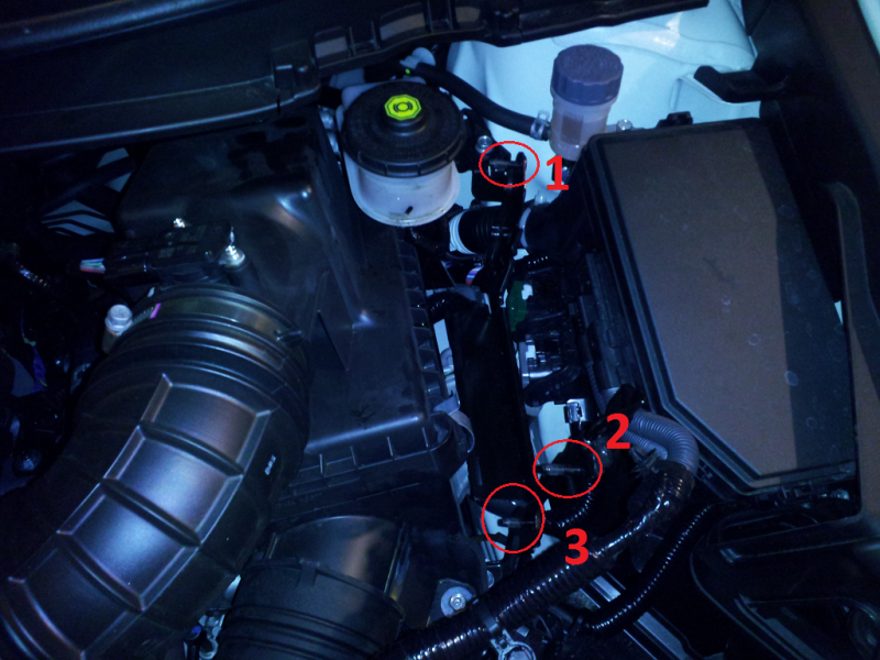

you need a small 1/4" ratchet, 10mm socket, 10mm deep socket, 10mm wrench, & a flathead screwdriver to get at it. Bamathrasher did it -
As you can see in the picture above, the ECU is in our engine bay on the driver's side, between the airbox and fusebox near the firewall.
Step 1 (optional): Using the 10mm socket and ratchet, remove the positive and negative battery terminals and loosen the battery tie down bolt enough to move the metal hook. Swing the battery tie down away from the battery and gently pry up on the black plastic battery box to remove it. Now completely remove the battery.
Step 2: Gently pull up on the black plastic cover surrounding the ECU, it should pull right off with very little force at all. You should now see the three 10mm nuts exposed highlighted in the picture above.
Step 3: Using the ratchet again with the 10mm socket, loosen the nuts until you can turn them with you fingers, but don't completely remove them. You may need to use the 10mm wrench if your ratchet isn't low profile enough to fit on the #1 nut above, the one closest to the firewall. That reservoir there can be kind of a ***** to get a socket on the nut.
Step 4: Hopefully you didn't remove the nuts completely, because the next part will be much easier if you still have some leverage to work with. I tried using my thumb for the next part and had no success, busted out a flat tip screwdriver and problem solved. There are 3 wiring harnesses that clip into the ECU, the way to remove them is to push/pull the black plastic clip towards the driver fender, if done correctly the clip should move completely to the right and you will be able to wiggle the harness out of the ECU with a little force.
Step 5: Now that you have removed the three different wiring harnesses, completely remove the nuts from the threads holding the ECU in place. The bolts don't move, they are a part of the bracket holding the ECU in place, so removing the nuts won't cause the ECU to drop. To remove the ECU push it away from the fuse box to push it off of the threads and just pull out to remove it from the car.
