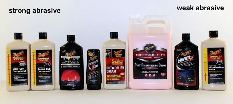

I probably would like a 12 pack. Thanks for commenting on that cause I wasn't sure if I would need more pads to use. Do you still think I can get away with just a one step polish on the M205? After that I have a sealant but I don't think it has any cut.
Sent from my Pixel using Tapatalk
52,105
22,314
if you need more cutting than the 205 provides, you can also try ultimate compound. I've done an entire car with ultimate compound before and the results were fantastic. It's derived from m105 but less abrasive. It's like between the 105 and 205. I'm sure your paint is nothing like this car in the video below, and look at the results with ultimate compound.
View: https://www.youtube.com/watch?v=Po39KcVjbLQ
52,105
22,314
Sykobabble
54
10
Chicago
Civic Si Fast Edition
Two Door
So maybe the ultimate before the 205. Thanks again guys

After taking a closer look now that the sun is out, the cars paint is in excellent shape. Very little marring or swirls. I think I can get away with a one step polish. Thanks all
