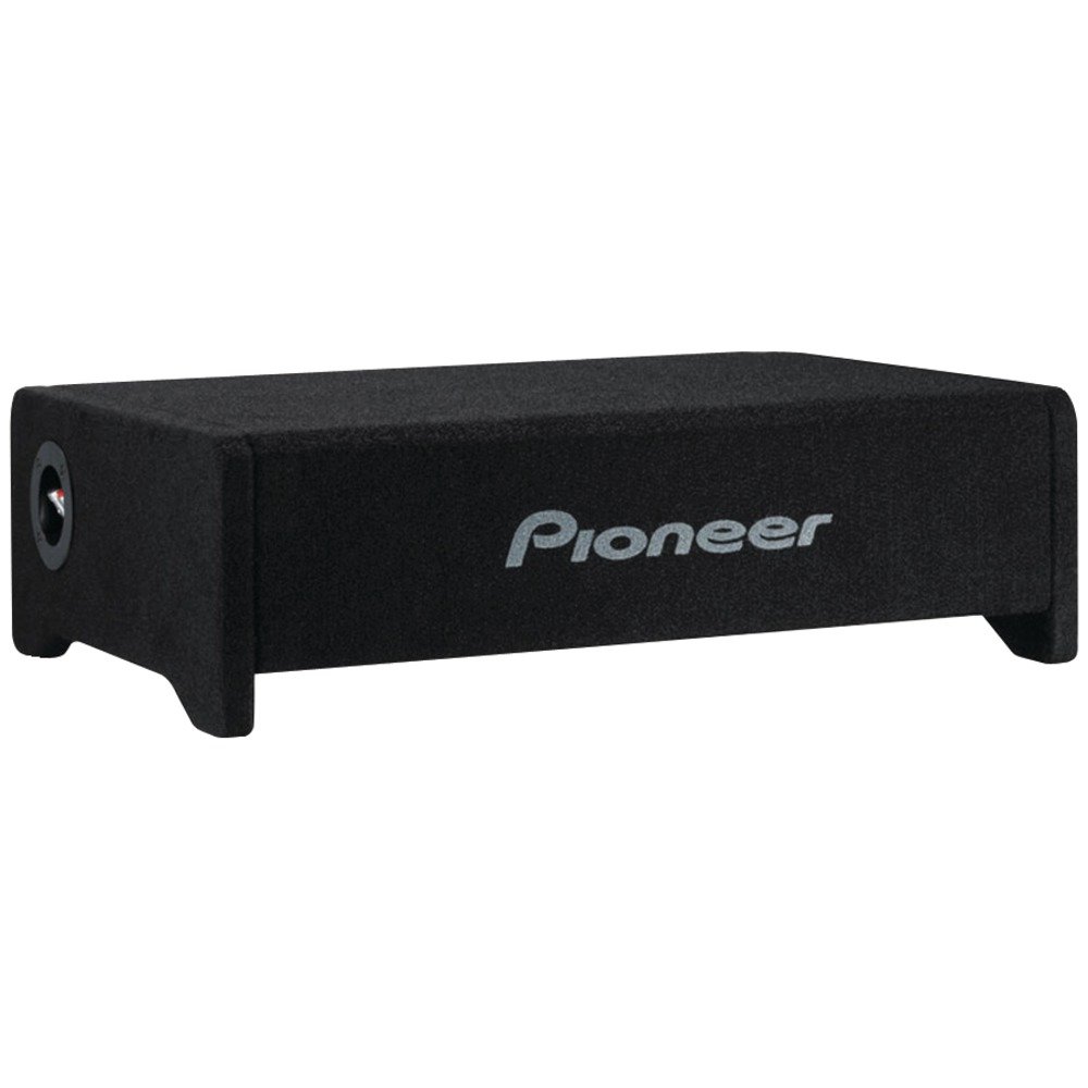

The effort to install and length of time is not a big deal. I am super meticulous when it comes to cleanliness of installing anything. Not just car audio. I am trying to avoid filling up the trunk as much as possible. As it stands, I may only put a single shallow mount 8" sub in. I don't need it to be crazy thumping loud. Just well balanced. I would also make it easily removable. the following combination seems to be well reviewed.

Ive done a setup like that before and my opinion is if your gonna just do the sub then fine it'll give it alil more depth with the bass but if your gonna do after market speakers all around then amp them that box is not gonna be enough to balance out bass mid and treble ....your inside speakers are gonna over power that box it being a flat sub and not that much power can be put to it .
Id say one 12" in a single band pass box wont take up alot of room and itll match bass mid and treble .
