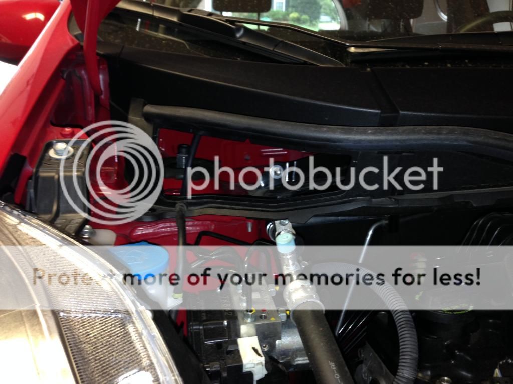

Well....got the front done and put in new brake pads. What a pain in the FRIGGIN ARSE!!!!!! Such small spaces to work with. I should of followed my gut and just ripped out the cowling. Ended up having to do so to find a lost nut.
I utterly hate how the Fit does not have the "traditional" 3 bolt/nut top hat like the Civics and pretty much any car I worked on. Well, wouldn't hate it so much if I would of removed the cowling first and then the entire wiper assembly on the drivers side...lol. Pics below will explain better.
This is the pass side, popped of the little door with is maybe 3 inches tall. Took me 6 turns of the ratcheting wrench(which I had to run out and buy since my 17mm had disappeared) to make one full rotation on the nut. Took me 20 mins to remove the nut after it broke loose
This is the drivers side, same little door is off. Wiper assembly and brake fluid cap create space issues. Took 30 mins to get the nut off after it broke loose
Since there is almost no room on the drivers side, I ended up pushing the nut behind the strut location. Messed around for a bit to try to fish it out and ended up pushing it further back! FAIL! Removed cowling and wiper assembly to finally get the important nut. Wasted about an hour!!!
