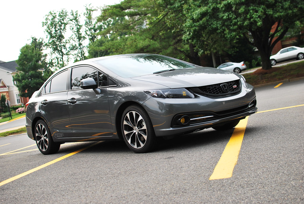

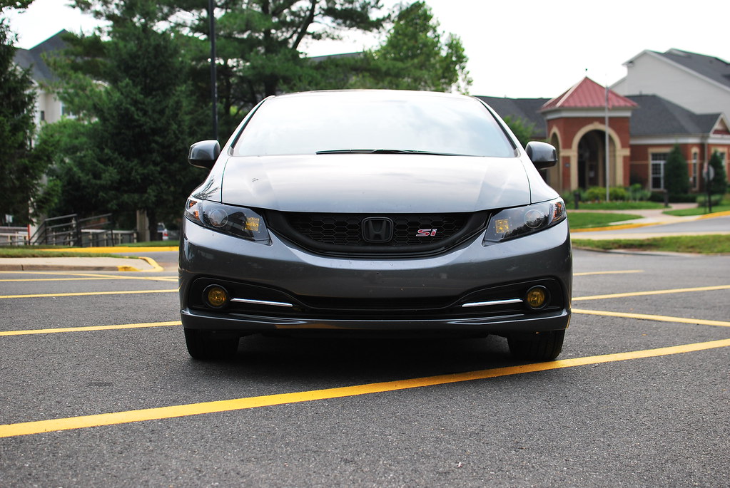

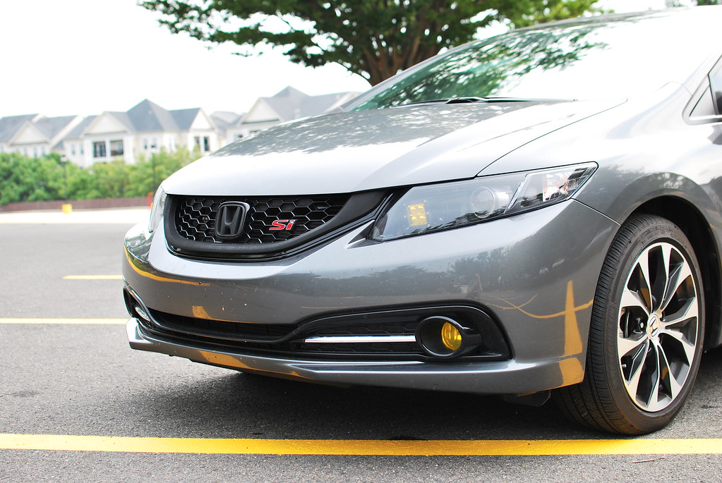

From my last Si. I went for something weird. They turned out weird but the Duallys were great as fogs without turning the headlights on and the FX-Rs were awesome. Which was great because I wasn't satisfied with the looks haha.

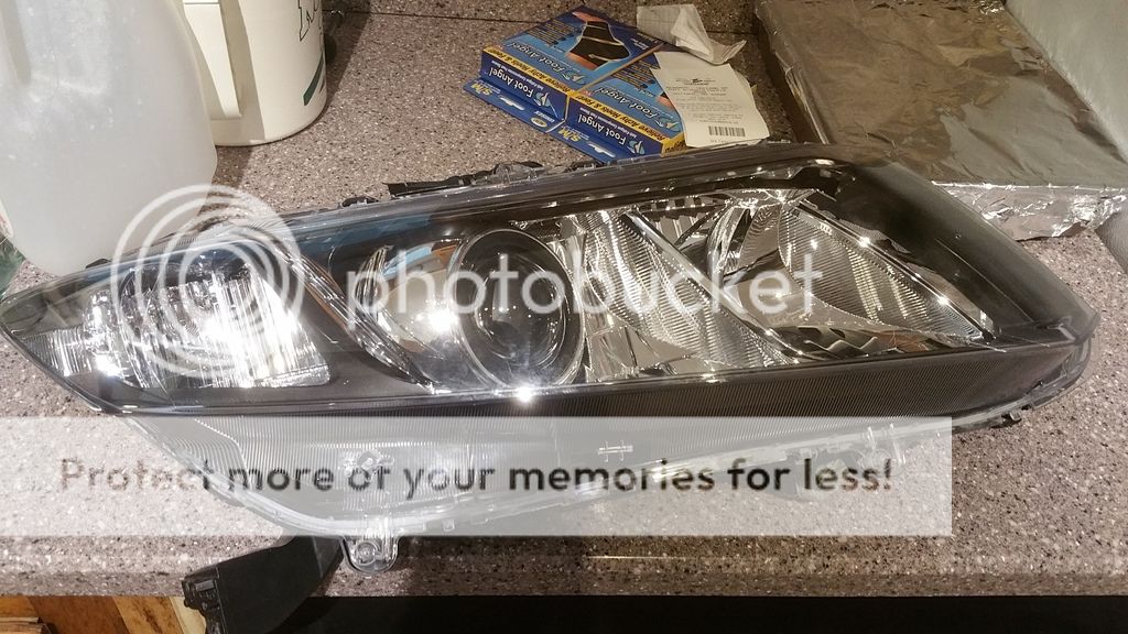

Well Finally got my retro done. Very pleased with the outcome. Ill get better outside pics after I wash my car.
