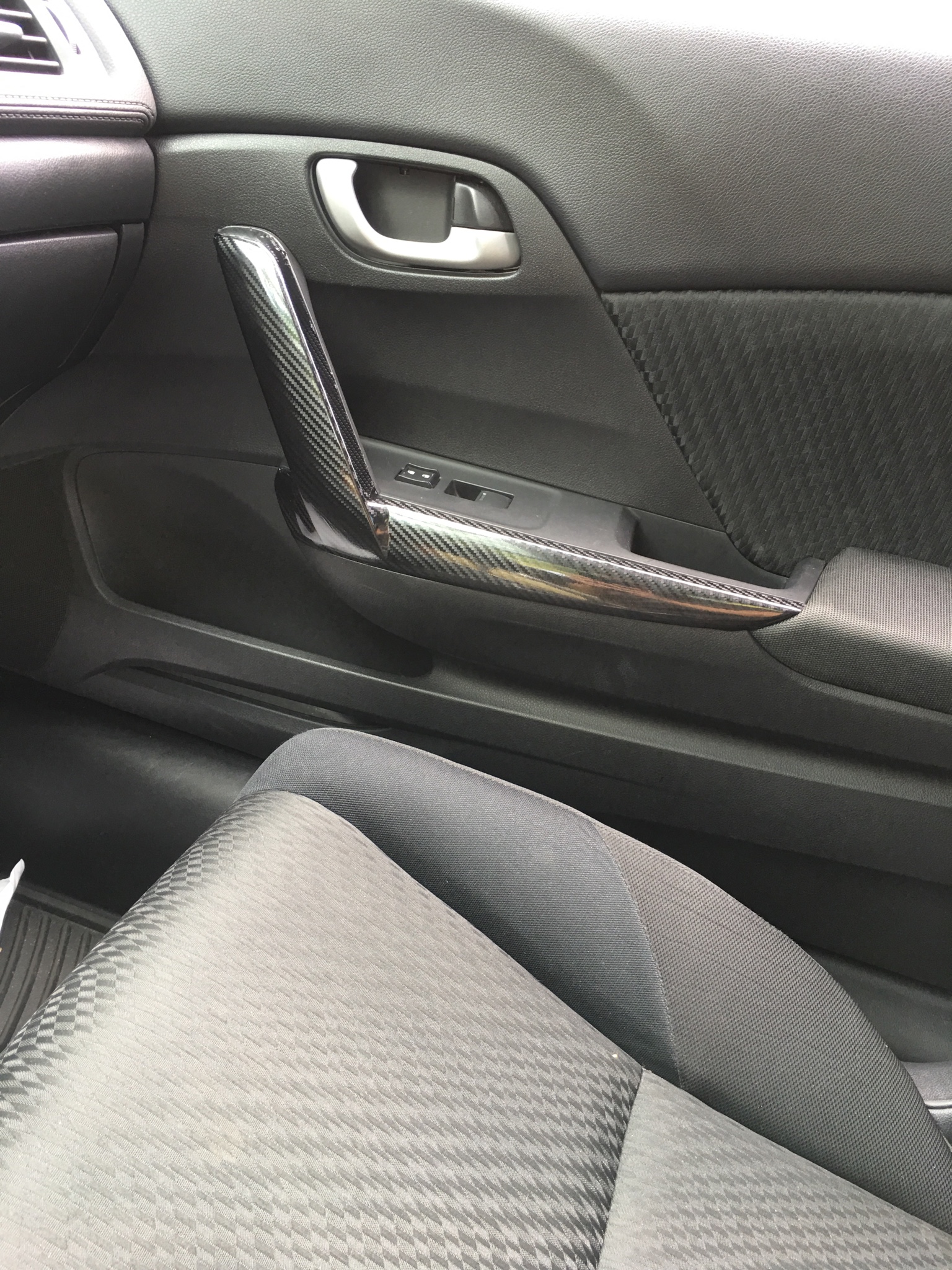

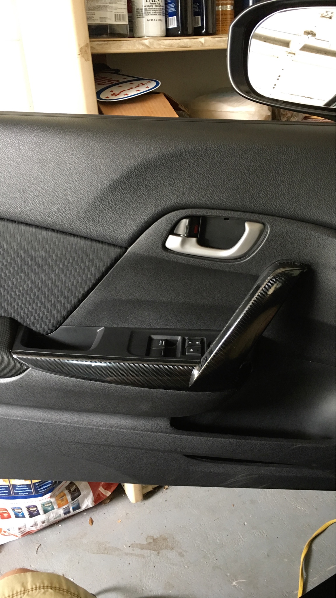

Looks good. I've contemplated vinyl wrap, but don't wanna botch it. Might take a plunge when I get back to the states
I won't say it's easy, but it's not that hard either. Just be patient and use a heat gun or hair dryer religiously.
